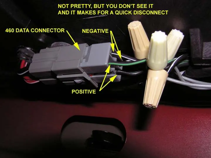

I have a 97 cobra with verified bad amps.The car place game me an amp jumper plug,but it doesn't fit my harness amp in or outs.Can anyone tell me
where i need to jump them out at.Thanks
Not sure if the '97 is the same as '03, but it is a 460. Here is where I spliced for a pre-amped signal. I did it to run the signal to a new amp and subs.
If you lay on your back, in the trunk, you will find this connector between the rear seat and the 460 black plastic box. It is stuck to the underside of the rear deck.
See my post for schematics on the Mach 460 :nice:
Hope this helps
