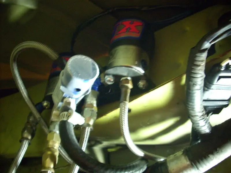

Today, I rerouted the nitrous system. I had the solenoids attached to the strut tower brace. They were always in the way, and looked retarded. Plus, it basically made it impossible to drive around without the strut tower brace. There wasn't any good place for them in the engine bay. I went up under the right fender, and removed all the smog valve control stuff up under there. Turns out, you can use the smog control hardware to mount the solenoids. I thought that was nifty. I would be done tonight, but I ran out of shrink tube. I'll have to try and make it to Home Depot tomorrow to get some more, but it's suposed to snow.
My water pump should be here tomorrow. Hopefully get that done. On Wednesday, I'm suposed to change out an entire suspension system on a friend's mustang.
Kurt
Solenoid work is all done. There is a little frost on the fuel booster in this pic from the test run.
Kurt
