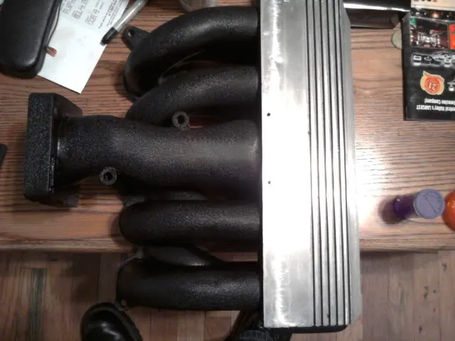

Finished painting the intake.
Used VHT wrinkle plus rattle can.
Not perfect,but came out alright.

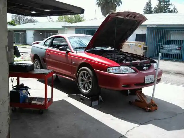

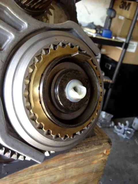

Pulled the t5 to replace the tailshaft bushing and seal.

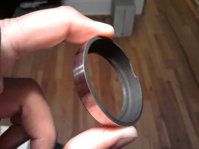

Broke the reverse syncro in the process.
Cannibalized a v6 t5 I had laying around to fix it.
Got that all wrapped up.

Just got the new part for the reverse syncro in today.
Putting the v6 t5 back together tomorrow,and up for sale on the CL.
