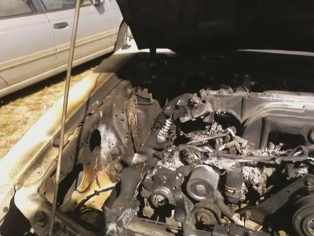

My winter projects are going slow, but progess has been made. I put the engine in the 95, only the wiring needs done and paint. My 1993 notch has been revived and primed after a very disappointing surpise barbecue:(.
Sadness!
