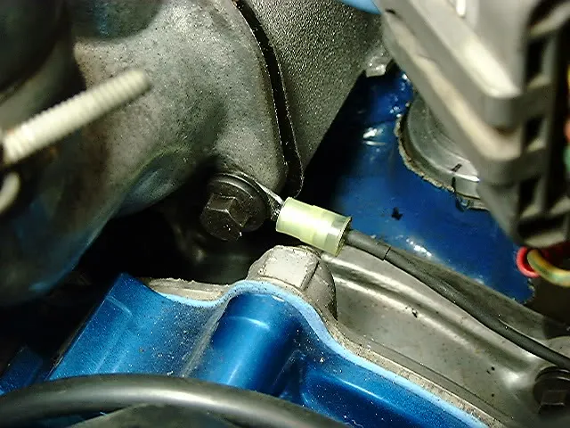

i have mine wired into the acc for the radio.
the temp probe i have attaches to the thermostat housing.
