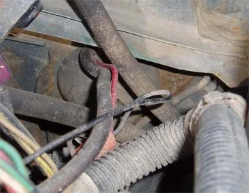

On the bottom left of the rad there is a metal piece that i drilled through into the rad , i then soldered using a torch a nut that the temperature sensor will screw into over the hole .. screw it in - attach the power and fan to the switch and there ya go.
I thaught id add that I never get any leaks or anything and its been 6 months since i have installed it. I know it was kinda risky doing this but i only paid a few bucks for the rad since i got it from the junkyard anyway!
I uploaded some crappy pics just so you get the idea , my car is really dirty as you can tell under the hood :P .. i live in canada and drive it year round so the conditions make it hard to keep clean.
