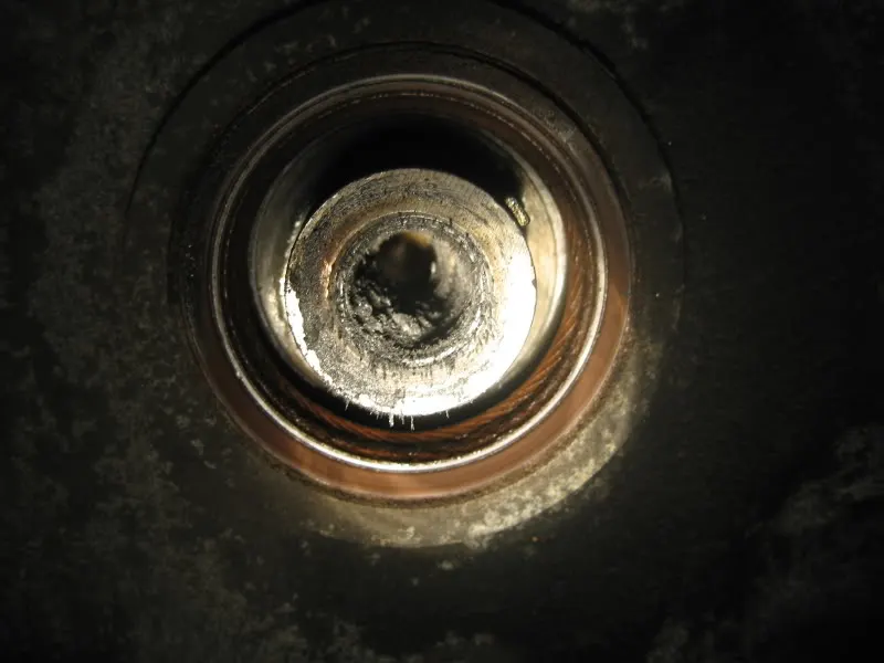

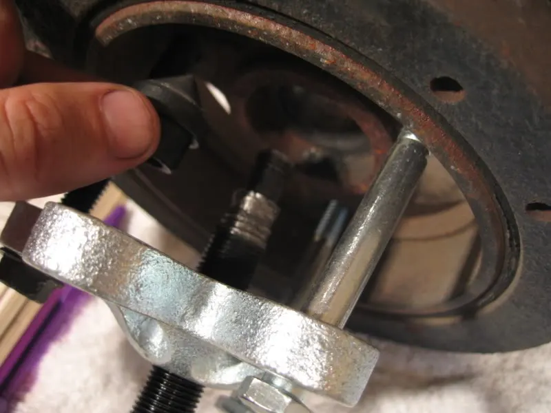

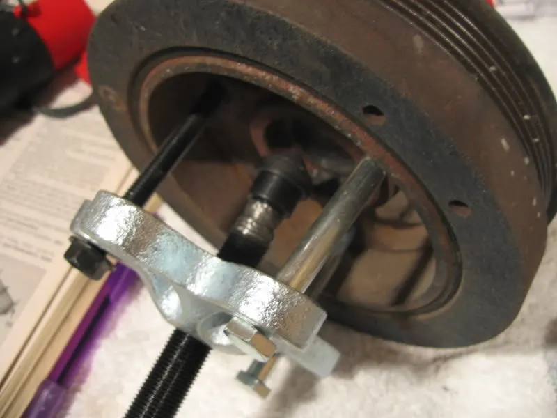

So i finally got off my vibration damper and realized what I was doing wrong......there was a little piece that I was supposed to slip over the end of the the bolt that went through the center of the tool (the one that applies pressure to push off the damper)....so without that piece on there the bolt kept working it's way farther and farther into the crank...
Here's the tool and the piece I didn't put on and the aftermath in the hole...can't really see in there..in fact the pic below is the best view I have.....You can see without the tip on it was too narrow and just kept going farther in
I know.......I messed up......do I have something to worry about here or should i be ok?..............dammit:bang:
If it didn't chew up the threds on the crank it should be fine. As long as you can still bold the pulley ( i assume you are putting on pulleys) on and it doesnt shake or wobble it shouldn't cause any problems. I had a similar problem with mine. A buddy put them on wrong and i had to fix it but no damage was caused.
As others have said, first get the tap for the original size threads. Clean out the threads. If there many threads gone at all, you can get the right size heli coil at Napa. I have first hand knowedge on this, as some debris got in mind and chewed up the threads. I was told by the ford dealer, and about five other shops I would need a new crank. It has now lasted over 70,000 miles with the heli coil with no problems at all. I had to take the radiator out to get the drill in there straight, but other than that it wasn't a big deal.
there's a decent amount of threads gone, you can see just from the tool.....but it's good to hear that you had good luck with the heli coil....I'm going to look into that....
I started this project just because of a blown spark plug......so by rational, maybe I should replace the whole block eh?:D
I don't know man...it is the crank pulley. You don't want to have that thing fly off at 5000 RPM's. Try the tap route and see if that works.
I did the same thing. Once it got tough to turn I stopped and realized I was doing something wrong. That is when I realized I need that exact piece you show in the picture.
