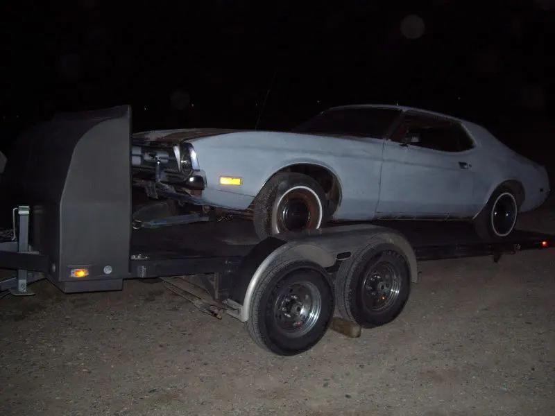

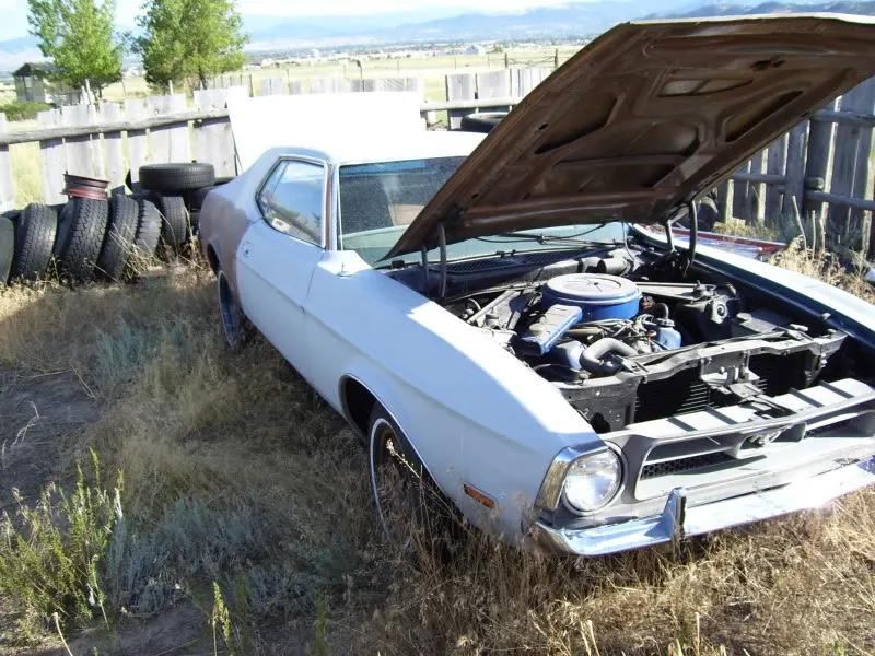

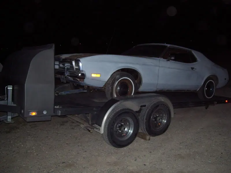

My car is a 73 by the vin but the PO told me that he thinks that it has has the front swapped out for a 72. I need to replace the pass front fender and don't want to order the wrong one as there seems to be a 1 year only 73 fender.
Right now this is the best picture I have of the fenders
73
71-72

There were no Chrome Bumpers in 73, No Chrome fender extensions.
So the Front is a 71/72.
If you have a 73 Vin??--Do it right, put on the 73 Fenders, 73 Bumper/Valance. Hoods are same 71-73.
To install incorrect Fenders, spend many $$$ on a restore to have a Non Correct, Freak "If you will" Mustang will be worth less money in the end?.
So do it right, take you time, build the car correct.
Dan @ Chockostang
Dan @ Chockostang

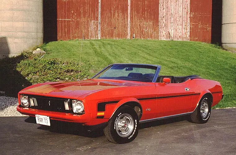

I weighed one for shipping once. 90 pounds without the brackets.
On the other hand, I wouldn't say the 73 front is butt-ugly:

That is a purdy car, I have no love for chrome and that will be going away as well the bumper guards and trim around the car, all media blasted and painted to match.
I will be leaving the 72 front on the car, I don't have the $$ to swap everything back over nor the motivation. The hood will be changed to a nasa hood w/ functional scoops. Going to look at a wrecked car in the next couple days:nice:
