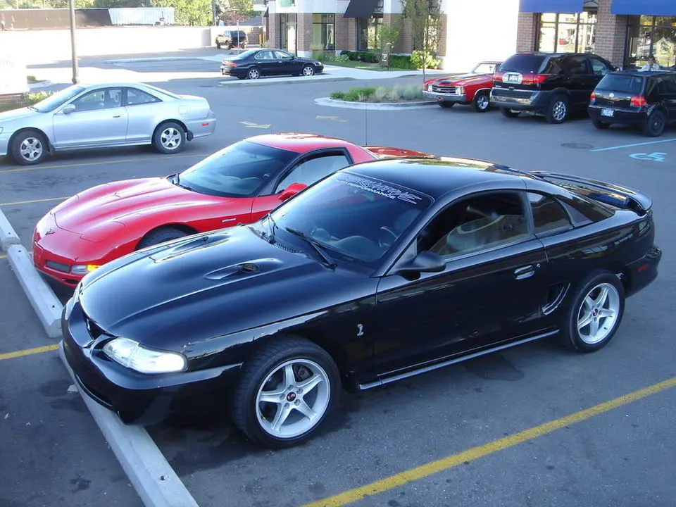

the wheel is a totaly different cast. they didnt shave down the hub. they moved it inward and in to some degree, lengthened and changed the angle of the spokes to get the lower offset. the width of the wheel stayed the same.
Don't buy the 36mm offset Cobra R's. They are ugly as can be. They totally changed the cast of the wheel. Buy the +24mm offset Cobra R's...like these...this is my car.
These have a +24mm offset too...but these are the goofy ones.
