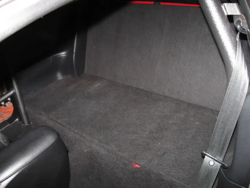

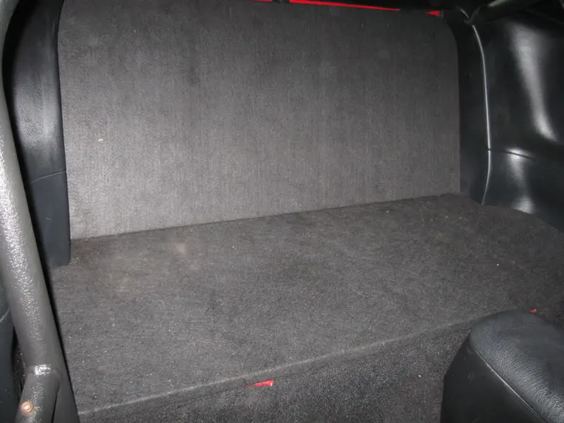

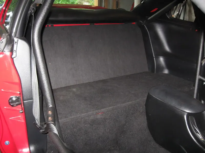

Finally got it done, it was cake after I got the rear seat lower off that was a major PITA it should have never been that hard and the whole process would have take me an hr to do if it was not for that f'ed up release button and not taken all afternoon to do it. It came out good over all it did not mount in anyway it was form fit so you had to push it into place and it was a very tight fit. There is still some metal showing at the top of the back seat as you can see in the pic I may fix that at some point and put some black cloth there but for now I'm done screwing with it.

I should have weighed the seats VS The kit. Its made of wood w/ thin carpet over it. It has some weight to it but I don't believe as much as the seats b/c the backs had the metal brace that went all the way around it. I went out and re adjusted the seat so the red metal no longer shows it just needed to be pushed up more, I took the bottom see off b/c I forgot to take the seat belts off from the rear.
How is your bottom part held in? My bottom part has a big gap in the middle where it does not go flat on the carpet. This is because on the outsides wires under the carpet raise it up.
Its all form fit, it just pushes into place. Its a very tight fit and needs a lot of persuasion to get it into place but IMO is better then having to bolt it up b/c it leaves no gaps b/c of the tight fit.
