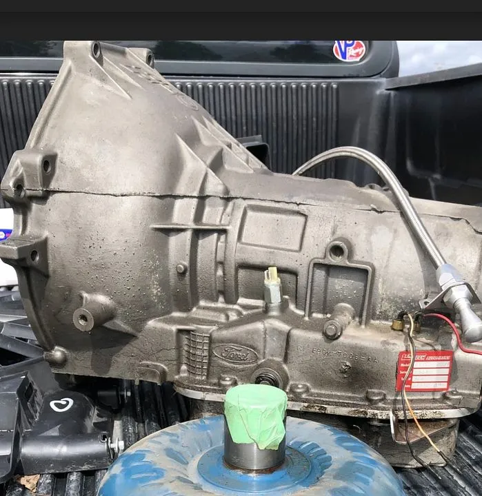

HI. I am about to install my Lentech Valve Body in my AOD. The vb came with the fitting and wire, but I am wondering how you guys drilled for the fitting? I have a deep Trick Flow pan, and figure I could probably just drill and tap the pan either on the side, or bottom. If any of you have done this I would like to know your opinions. Pictures would be helpful if anyone has any.
Thank You

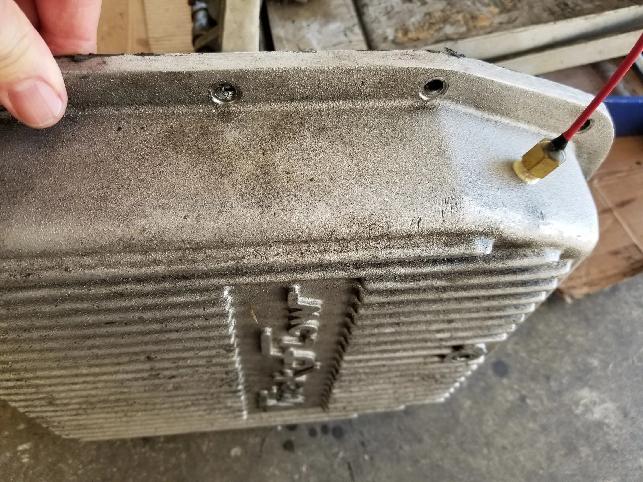

Found this picture:
Also, if you do a deep pan you may want to get a filter that will locate further down in a deep pan. Read where the filter from a ‘92 Bronco, 302 4X4 will work and the AutoZone P/N is TF202.
