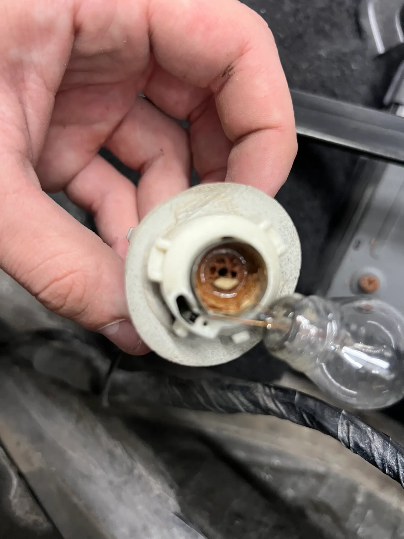

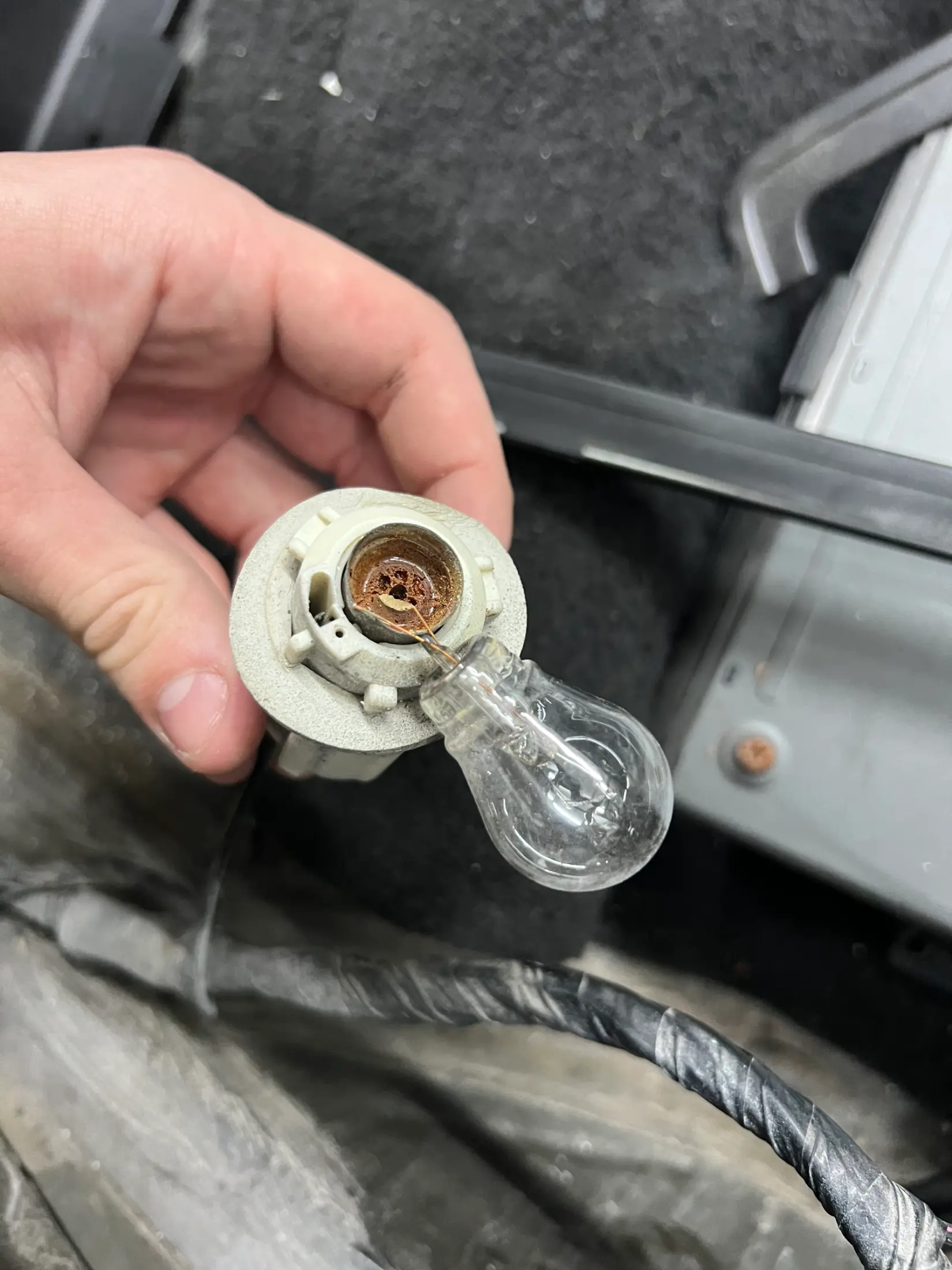

AnthonyA1234 5 Year Member Aug 17, 2020 674 111 63 Florida Oct 16, 2024 #1 Oct 16, 2024 #1 I’m pulling on them with pliers and they won’t budge. I see what looks like a hole to push some sort of release there but I push it and it doesn’t help any. How do you get these bulbs out? Attachments IMG_1387.webp 118.2 KB · Views: 135 IMG_1388.webp 92.2 KB · Views: 133
AnthonyA1234 5 Year Member Aug 17, 2020 674 111 63 Florida Oct 16, 2024 #2 Oct 16, 2024 #2 They twist out I got it Reactions: General karthief and RaggedGT

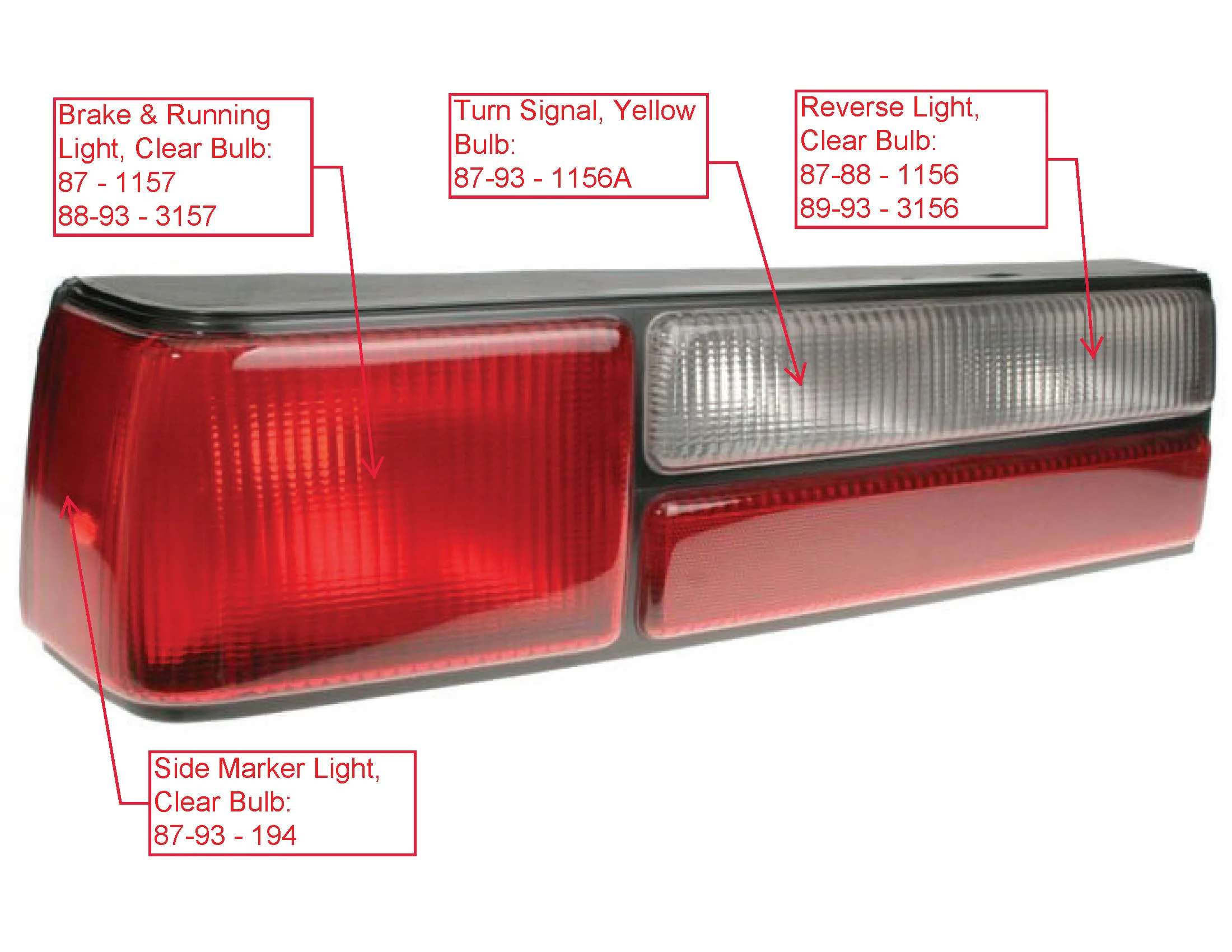

AeroCoupe lube between the nut and the face. I know my lubes Founding Member Oct 28, 2001 6,254 4,339 183 Claremore, OK Oct 17, 2024 #9 Oct 17, 2024 #9 I think this is correct for 87-93 LX tail lights. If not let me know and I will correct it. Last edited: Oct 17, 2024 Reactions: gkomo, General karthief, 91AOD5.0LX and 1 other person
