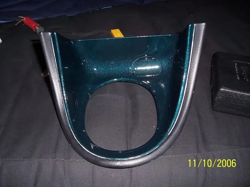

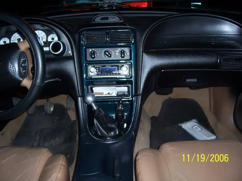

The Green GT No 13 year olds are safe around me. 10 Year Member Jan 8, 2006 1,269 19 99 Louisiana Mar 12, 2007 #2 Mar 12, 2007 #2 there is a long arm on the back of it. Its screwed onto a metal part in the dash. Its a tamper proof torx bit IIRC. Ill see if I can find a pic. I know I took one. Its really hard to get to. Actually its a HUGE PITA mainly because its so far back and its cocked upwards. EDIT: Take the bottom storage hole out first them pull the shifter bezel out first. This is how mine turned out. Ive since painted the whole interior black and gotten new seats. Attachments Picture1011-1.webp 65.8 KB · Views: 353 Picture1030.webp 41.3 KB · Views: 352
