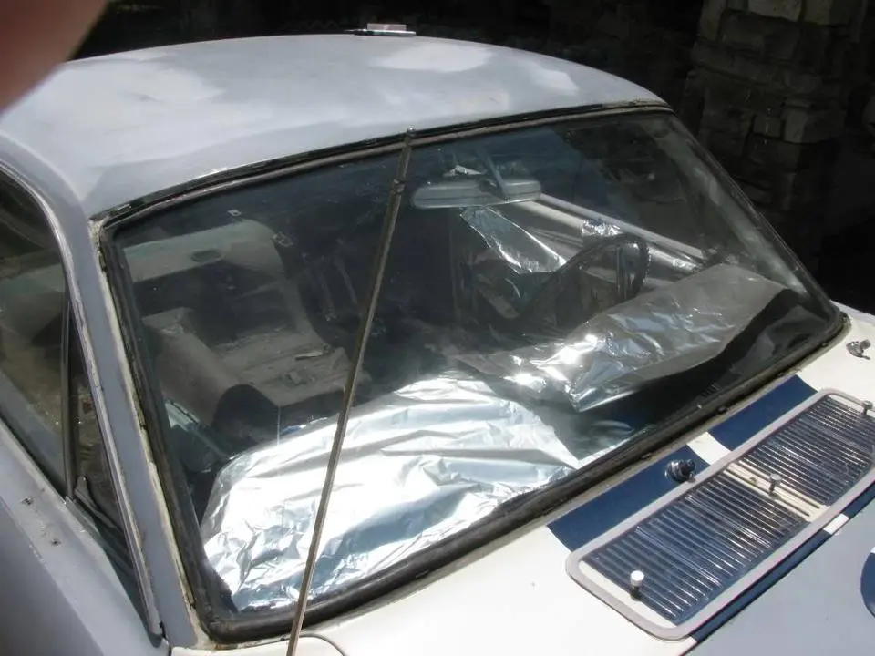

How do I remove the window trim?

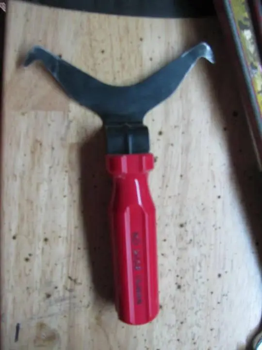

THose things are held on by a little clip about every 8 inches or so around the windshield. YOu need a window trim removal tool that will have to wedge between the glass and the trim and hook that little clip and pull it down to release the trim from it....you might can find some videos off of youtube. The tool is relatively cheap...could make one if you had to...but its not a hard job, finding the clips is the hardest thing.

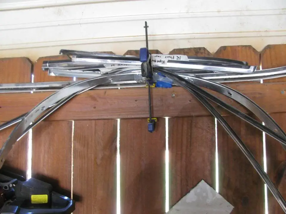

As far as the window trim goes...each piece will only go one way, so its not that bad to figre out where they go. Good opportunity to hit them with some polish and make them shine like new.
After about 3 hours of tugging and prying it worked.

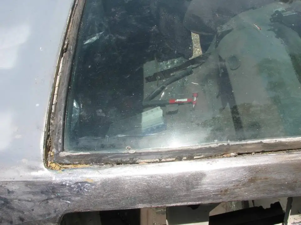

Sorry I missed the Party, when I'm planning on removing the glass, I cut the rubber seal with a box cutter under the trim moldings and pull it out with some needle nose pliars. It makes it alot easier to get the trim removal tool in there to release the clips.
