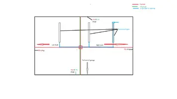

I'm running 6 gauge wire from my panel to 4 outlets on each side of the garage for 50amp outlets for a welder (I like to have LOTS of options). The walls are drywalled, so it's going through conduit, all junctions and conduit is on on the surface of the ceiling.
On the middle of the ceiling will be a junction and I want to split 3 runs from that - one to the left and right walls, and one to the front of the garage between doors., so I need to take 1 6ga run and split it into 3 (I'll have another split near the panel for the 50A plug that will be located near that).
I have a normal junction box on the ceiling and have quickly figured out that isn't even going to be close to big enough, so I'll replace it with whatever size is necessary. My conduit is sch-40 and isn't glued together yet because I figured I would have to make changes.
I can't seem to find bus bars (and how would I mount them in a junction box?), and split bolts I've found 'only' split 1 line into 2. I suppose I could use two 3-way split bolts, but dang that's going to make a mess in the junction box when I wrap them.
I also be running some 10 ga with the 6 ga so I can put in a 30 amp outlet on a separate breaker (like I said, I like options). That's only going to the front of the garage, though.
I'm using sch40 conduit and all my wire is THHN stranded (boy is that a lot nicer to work with than the 12ga solid core run throughout the house)

1) The main fuse panel is a 200AMP GE panel. I've got spare slots for breakers, and that is the panel these circuits will come from. It is on the back wall, opposite from the garage doors.
2) The 30A circuit will be on it's own fuse, with the 50A circuit on a separate one. (Maybe I don't understand what you mean)
3) There will be one 50A circuit. I have 6 gauge wiring and want to split it on the junction on the ceiling to run wiring for a 50A receptacle on one wall of the garage (the left wall if you are looking at the doors) and between the garage doors. Possible a 3rd branch to the right wall as well. Near the panel I also wanted to have a 50A receptacle, so I'll have 50A receptacles on each wall. They will all run on the same breaker, and I would never be running two at the same.
The 30A outlets have their own circuit but will be fed off of the same breaker. I'm using 10ga wires for that.
My problem is splitting one 6ga wire to go to the other 3 receptacles on the left right, and far wall between the doors.
4) I want receptacles on all the walls so I can plug the welder in anywhere - it's 240V/50A max draw. We also have an RV we may want to plug in, and my mom does as well, so if they ever visit with it, I want to give them a place to plug in if needed.
The 30a receptacles are for other tools that might need them. I suppose I could just get an adapter and unplug the welder if I needed to .
However, you're the second person to suggest just getting a 50A extension cord and that makes a lot of sense - not sure why I didn't think of it. I would still want a 50A receptacle on the wall between the doors and one near the fuse panel so I have options of where to plug in at. I could build the extension cord out of my 6ga THHN, right?

Hi,
I understand where you’re going now. If you can answer the below, i’ll lay out the best, most cost effective option..
I’d initially noted the fluorescent lights & no lines on your drawing for 120V Circuits. Are you planning on adding any surface mount (ceiling drops or wall) 120V Circuits?
Additional overhead Lighting?
The 240/30 Circuits are not dedicated-correct? More of just planning ahead?
As for the most logical layout, that depends on Shop dimensions. What’s the length & width?
- As for the 240V/50A extension cord, it’s a handy thing to have. Will a 1”+ diameter cable get in the way running across the shop?
I’d suggest the design from the onset not to REQUIRE ithe extension cable’s use, more i
You can’t drive over these, it’d be a 6-3 Type Soo cable.
As you’re still in pre-construction phase, IMO- setup things as convenient as possible now, you’ll be working in there.Less obstructions..the better..
I’ll lay out the most logical & cost effective setup once you list your preferences, just take a few minutes.

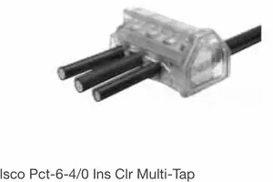

PS: Connecting the #6’s in parallel is much simpler, more effective, space saving using the blocks I’d listed above. Set screw clamps the wires together, cops pop on, insulated to 600V..
Having multiple 50A outlets on one circuit may not pass local code. You might want to look into this. It's perfectly safe though as you stated only one would be in use at a time.
Making a 50A extension cord, depending on the length, and the current being drawn could pose an issue with voltage drop over the length of a longer run.
I've used insulated taps such as listed above in a larger junction box to make splices with larger wires. You can also use the copper split bolts, but then you'll want to wrap them in rubber tape, and then black electrical tape to insulate them.

From SE panel both 30A & 50A wiring runs to a pull box, wall mount. Split your #6’s & run your #1 240V/50A receptacle nearest the source where desired. Your other (1) 50A & (2) 30A conductors also run through this box & via Conduit run up the wall across to building midline ceiling mounted pullbox #2. Your 240V/30A circuits run out to the R&L walls & land where desired. The #2 240V/50A circuit continues to the building’s furthermost end & down the wall where desired.
Would you like to combine PVC/EMT/MC/BX or multi conductor cable for these runs, or stick to PVC?
I’d recommend 12” Square, 6” deep PVC boxes where you can pop holes & box connectors in wherever, plenty of space, and inexpensive.
I’d also suggest running Twistlock receptacles for your 30A circuits. Buy the plug(s) then, so when you need them, you’ll have them. I’d run twistlocks for the 50’s as well, but at the 240V/1Ph/50A receptacles things get pricier, easy way out is just running economical 240/50A Stoveplugs.

***Better pic of what an insulated multi tap would yield you in space & aggravation of wrapping split bolts. They’ll sell the sizes you require at most H.Depots, or Granite City (if you have one, locally) your best selection & prices for most supplies.

An isolated multi-tap sounds exactly like what I need. My junction box is on the ceiling isn't large enough, so I'll have to get a larger one. Fortunately it isn't glued in.
