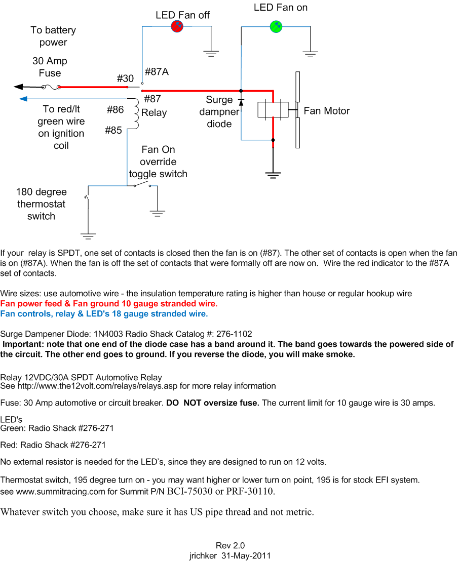

Do not use a simple on/off switch without using a relay. The high current load can burn up the typical cheap automotive switch very quickly. The fan draws 30 or more amps and you need to use #10 or #8 wire on the fan power and ground wiring.
If you are good with electrical stuff (90% of the people here aren't), build your own controller. The numbers on the diagram (#86, #87, etc) refer to the numbers on the bottom of a typical automotive relay.
Note that the temp sensor in the diagram needs to match the thermostat in your engine. The preferred arrangement is to have it open about 5 degrees above the thermostat.
If you are an experienced electronics tech or electrical engineer, email me and I will send you the prototype drawings of a fan controller that is similar in function to the DC Control unit. It is a build it, troubleshoot it yourself item. I will not build or troubleshoot units, so it is not suitable for anyone who isn't really good with electronics.
See my post at http://www.stangnet.com/mustang-for...-sooo-much-amperage-help.859590/#post-8645840 to get the drawings and full details.

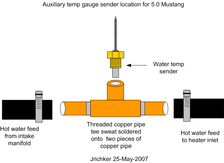

Alternate placement for a temp gauge sender or temp switch/temp sensor for an electric fan. Use the heater feed that comes off the intake manifold. Cut the rubber hose that connects the manifold water feed to the heater and splice in a tee adapter for the temp gauge sender. Be sure to use the same water feed line as the ECT sensor. That way you will get the most accurate temp readings.
Tee adapter info:
Make a pilgrimage to your local hardware or home supply center and get some copper pipe and a tee that fits the temp gauge sender. Solder two pieces of copper pipe onto a copper pipe tee with threads in the tee part. Find the correct brass fitting to match the temp sender threads to the tee fitting.
