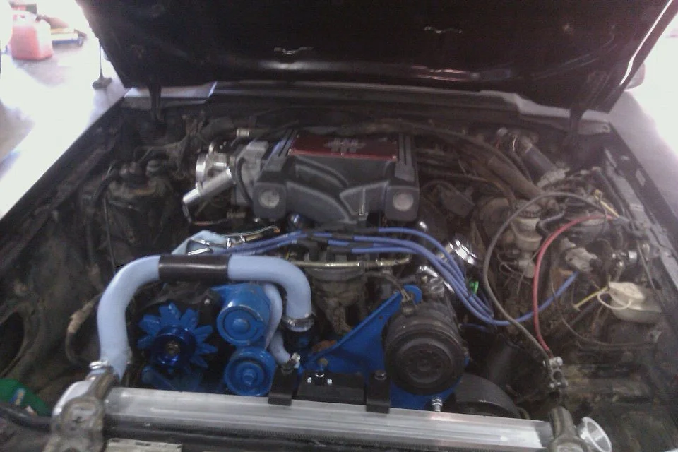

I can't say I've read anything good about those SSI intakes. Do you have problems with oil leaks?
I too have the "dreaded" BBK SSI intake. Not by choice. Came with Christine when I bought her. The fuel line thing is not an issue for me, I did some crafty -an fitting magic. The stock PCV grommet does not fit snug in the intake and occasionally falls out. No its not crankcase over pressure it just dont fit tight. But the thing runs awesome with it on. Rubbed the stock hood had to do a cowl. I'll certainly be buying a Track Heat at some point so I can have a stock hood and a strut tower brace.
I have the same issue with the PCV valve lol. My intake hit on a 2 inch cowl. I had to run an intake spacer because of my tall valve covers, so I assume without the spacer, a 2 inch cowl would work.
If you look closely you can see where I had to cut the supports out.

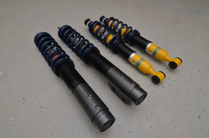

I wouldn't run Strange struts on a car you want to handle. And you need to know going in that there is hardly a better example on god's green earth of "you get what you pay for" than there is with shocks and struts.
Spend the money on Bilsteins and call that one a day.
Then spend the money on coilover kits that will work with them, and call that a day. Maximum Motorsports makes Bilstein-specific kits whose sleeves are designed to fit the slightly different Bilstein housing. Everybody else makes one-size-fits-all and then people complain "coilovers are noisy".
Spend the money on height-adjustable rear lower control arms and save yourself a huge PITA swapping springs 8 times trying to get your rear ride height the way you want it. They're expensive, but once you get them, you'll kick yourself for not getting them sooner.
I'm not a fan of poly bushings on both ends of the uppers, but whatevs.
Then spend some money on a local autocross school so you can find out what snap oversteer feels like, how to anticipate it, and how to recover from it, in the safety of a 50-mph corner in a parking lot instead of a 70-mph on-ramp.
All of this. Don't half ass it. If you want your car to handle seriously, expect to pay for it, but once you do you'll get back what you put in because you'll be destroying cars that cost 5x what yours did new. Also as an added bonus, most of those expensive parts are high quality parts that will last a long time and take a beating.
