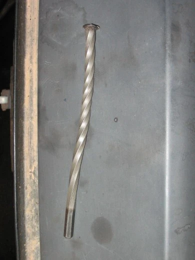

What happens to a chromemoly driveshaft when your oil pump locks up! woo hoo! My buddy thought he threw a rod it was so loud, engine was fine though.

wow to the pic, thing is thought, there was still a piece of the ds still in the pump and it i turned it perfectly with my hand so i dont recall it being locked up. But maybe i should pull the pan back off and inspect some more just to be safe
lmfao at the chromoly...
I snapped my oil pump DS just pulling my driveway. It sounded like the engine was about to throw a rod at me....so i shut it off and had a tow truck come pick it up, i might have ran the motor for 30 seconds after it snapped, no harm done for my bearings. Though i replaced the pummp and DS...and the oil twice in a row.
I once lost mine and drive it for about 5 blocks. Just had the lifters ticking.
So I just droped the pan and installed a new one. And I have about 20k since with 150 shot to it all the time! (the reason it locked up is b/c when I changed the valve cover gaskits there are these little metal biscuts that keep the gasket from getting squished out.... Well I learned about those the hard way! You should be fine, put some good oil in, and let it rip.
The oil pump DS on my old Mustang 5.0 snapped while I was about 10 miles from home. I drove it back home not sure what had happened. I replaced the pump shaft and that engine lasted another 60k miles.
