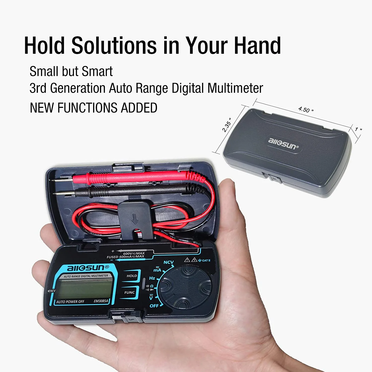

I have a meter stuck in virtually every drawer. Some are better than others and cost considerably more than others.
I've had my Fluke meter since high school. I also have at least two El-cheapo meters that are older than that.
I cannot recall an instance where I just had to have the Fluke meter because it's my [good] meter.
Here's all you need:
If you order them in a 6-pack and toss one in every drawer, you'll never have to go looking for it. :D
The accuracy is well beyond what is necessary for our archaic electrical systems. O_o

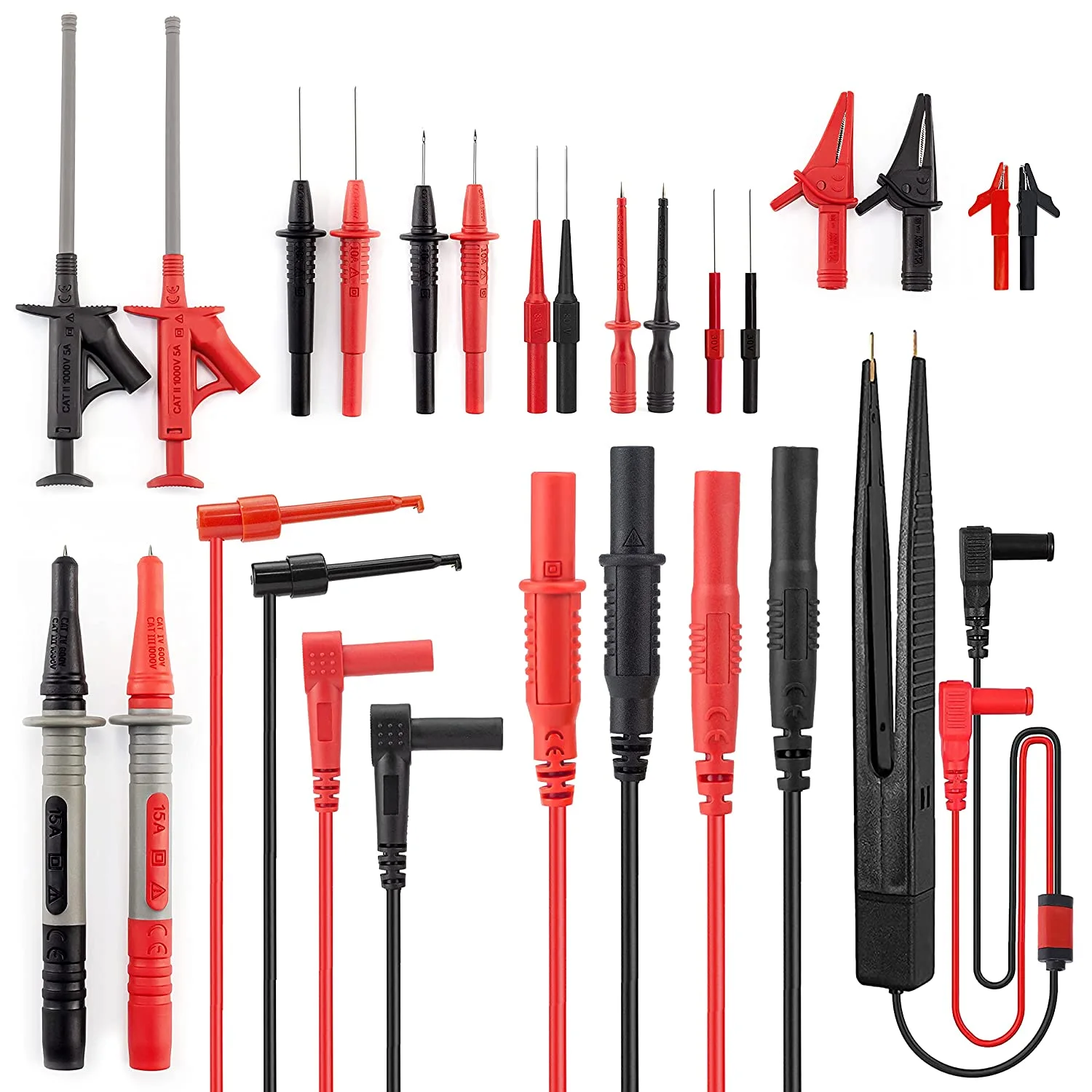

You'll get the best mileage out of [any] meter with a good lead kit (extensions, clamps, etc...). They are the extra set of hands that you always cussed about not having. :shrug:
I like the kits that have both extensions and spring clips.
