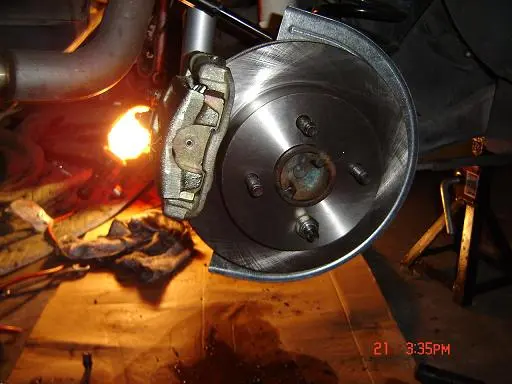

ssbc rear kit.same as cobra and turbo coupe.only reason i did it was i got the kit for dirt cheap.works pretty good too.

you have a good point. How much faster can you stop if you can lock up the brakes without much pedal effort?? I would say get yourself good shoes and pads and call it good. All this said with a rear disc conversion waiting on install.
