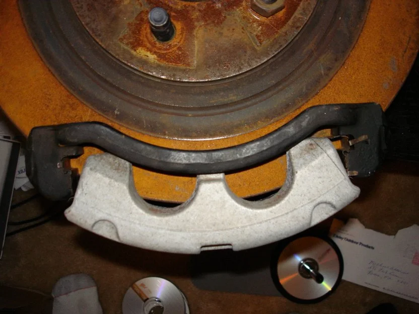

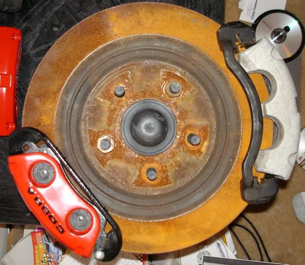

Someone on the 4.6 board a few years back had a good idea of making a bracket to bolt the GT PBR to a Cobra rotor. As good of an idea as it was, it can't be done. The curvature isn't right and the caliper sits up to high. Only half the piston would push against the rotor face.
