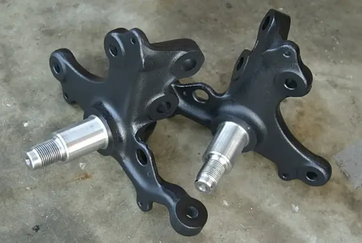

These are the spindles with the hubs removed.
Some of the earlier Baer kits used a Fox-style spindle in which the bearings themselves ride on the spindle and the rotor is a combination outer race and rotor which rides on the bearings.
Your best bet is to stick with a brake system that relies on the OEM 94-04 SN95 type front spindle design. The reason for this is because you will be able to go into any auto parts store, or Amazon, or Rockauto, and be able to buy parts for them. That's the key benefit of a production brake system, especially a popular one.
Some of the aftermarket brake systems use proprietary components like 13" cobra rotors built on a foxbody spindle/hub arrangement. If you need a new rotor, you are stuck and need to order one from the company.
Baer does make both systems although I believe their newer stuff is purely Sn95 spindle derived. Their brakes are fantastic and I am by no means tryig to dissuade you from them in general. But for parts availability and aftermarket support, a standard Sn95 spindle front setup is the way to go.
Reactions: slow84lx
Even my old 90s era Baers use the 96 spindle.
