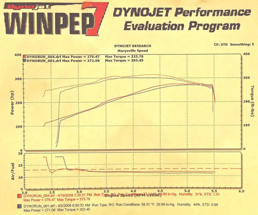

Click on the link in my sig for all of my mods, but that's the basis of what I've got.
The first pull was with a stock Cobra intake. The second with with a Tmoss-ported GT40.
