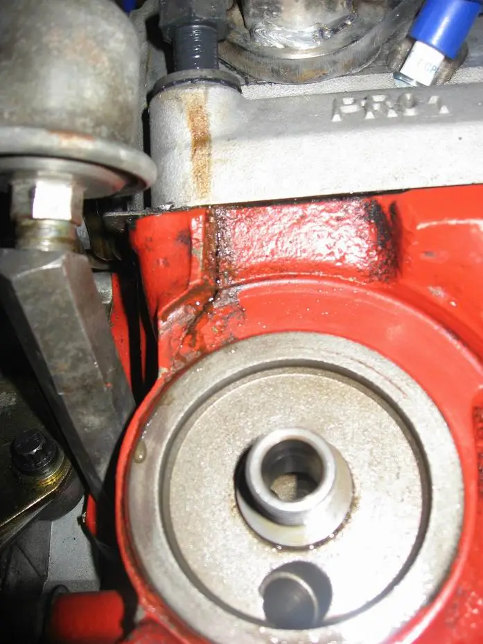

Hi. Bought a T&L built engine, .040 bore 302cid last summer.
After a while, I discovered a crack in the block near the oilfilter.
Rebuildt everything into a 1968 302cid, mustangblock, bored .040 over.
