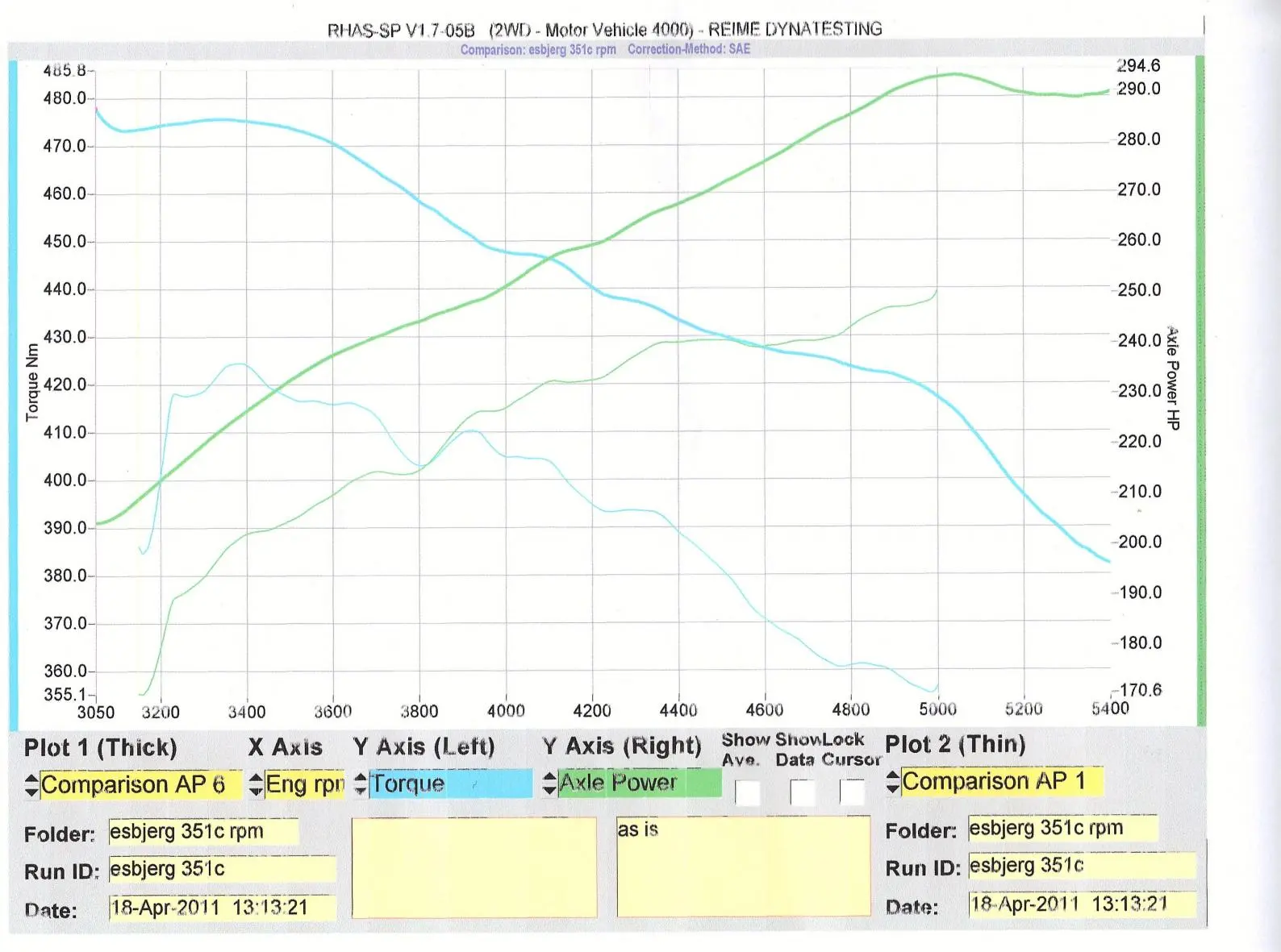

Here is the result of my Dynatestning.
I am very pleased with the results ...
See the difference before and after setting.
And it is true RWHP ..:D

Please don't take this the wrong way, I am not trying to be a jerk, but that's not even 1 hp per 1 ci, ie the ol' milestone of engine building, you can beat that with a high compression 289, so nothing to write home about, more importantly how much did that cost you?
Dude I never said it was, I was replying to robbz28 comment:
"This is just my estimate, but I would say about 420 flywheel horses and about 335 rear wheel horses. + or - 20 horses."
I was somewhat close....10 horses off and just going off of what he had in it...i think with a little tuning on the carb and timing you could get anoter 10 to 15 horses out of it....and 300 to the rear wheels is not bad...you can put that around 375 at the flywheel.
There is not a dyno within 100 miles of where I am, we have to estimate, and are pretty good at it.
