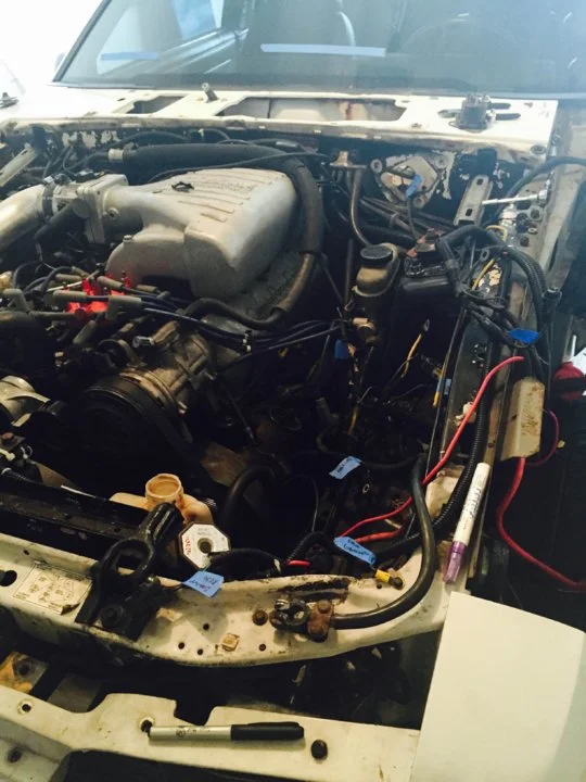

I finally picked up the car I've been looking to get for about 4 years now. A 91 LX coupe. I drove from Virgina to Port St. Lucie Florida to get it and trailered it back. The gentleman who I got it from had already done a lot to it and with a straight body, decent exterior/ exterior, a turnkey built motor, and a price tag of $4500 it was a steal. The downside is that the bay is kind of cluttered with wires and whatnot. Its bad enough I don't fully grasp the concept of the motors workings with out the mess of wiring everywhere. The car has taken on a good amount of rust in the expected water buildup points. This will probably be the biggest task to tackle. I am a newbie when it comes to V8s, Mustangs, or higher performance vehicles in general. Im a VW guy transitioning from the dirty world of german cars, stretched tires, and air ride suspensions :p I hope that I can spark up some of you guy's interest with this build and also I really hope I can reach out to you guys, especially in the beginning, for help for some of these things because Im honestly just a handy kid with time on his hands that has no idea what he's doing.

So far I've began cleaning up the bay, prepping for the battery, solenoid and distributor relocation.

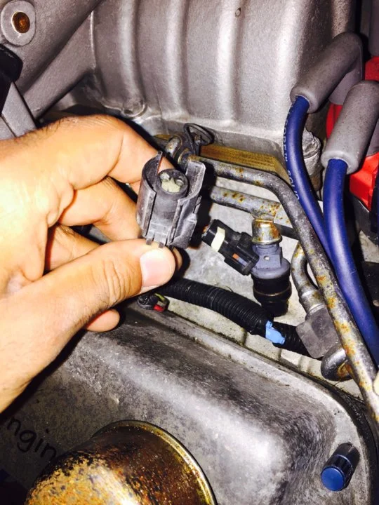

Ok so here's my first "What's This!?" Post. First and foremost please excuse my inexperience. I'm extremely new to these motors. If you guys recognize it can you identify it, tell me if I need it, and if I dont how to properly hide/delete.

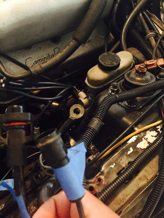

#1 found this in the driver fender.

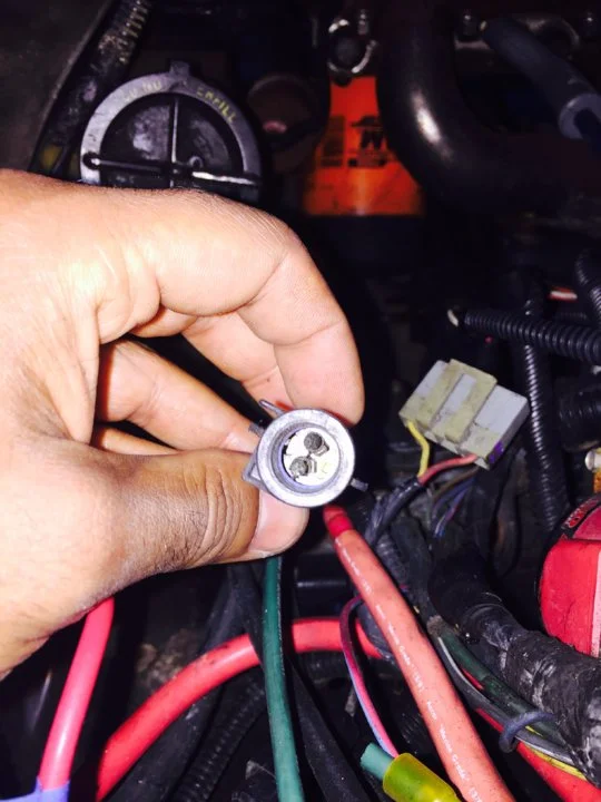

#2 disconnected seems to be coming from starter area

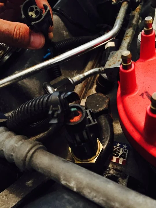

#3 are these the stock injector hookups? There's 8 all around the block, all disconnected.
I can't recall what the top one is off the top of my head.
The second one is going to be a plug for the egr or the water temp sensor on the passengers side. I am not sure which one. If the egr is deleted, then that would be my vote.
Joe
The one in the last picture is likely for the ECT sensor. I see no heater tubes, so it looks like the previous owner deleted the heater. The ECT sensor mounts to the heater tube in a straight-up position on foxes. Is the heater tube fitting on the intake plugged?
the box in the fender looks like some type of ignition spart box- if so, remove it.
I would highly recommend that you secure a chilton or subscirbe to alldata. In the interim @jrichker could you please provide this chap with some wiring and vacuum hose schematics. He's gonna need them.
There ya go, ECT is the correct term.
