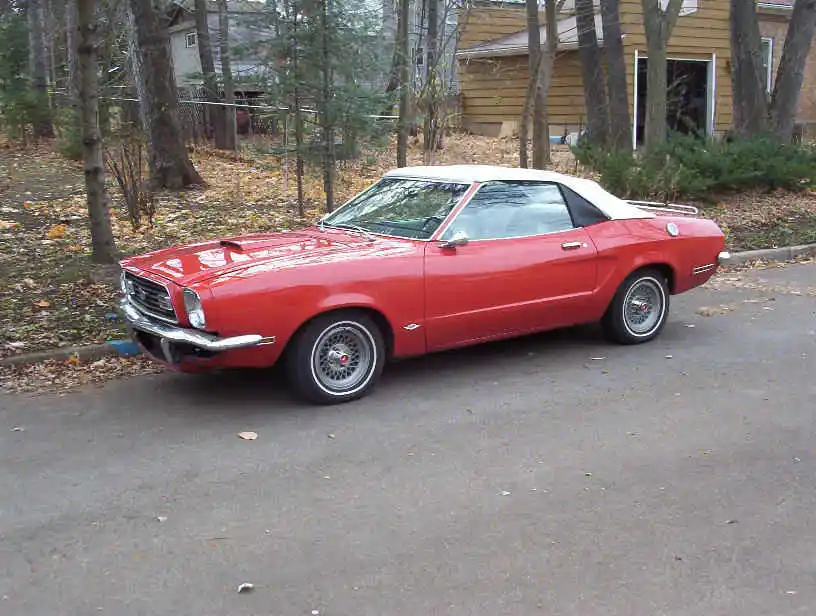

wow...i really don't have that much cash thoguh, thanks for all the offers, very kind of you. but it seems like it'd be easier just to take the whole roof off and make it into a convertible...lol now that..would be nice..[/QUOTE
Been there, done that. Wouldn't try it again...

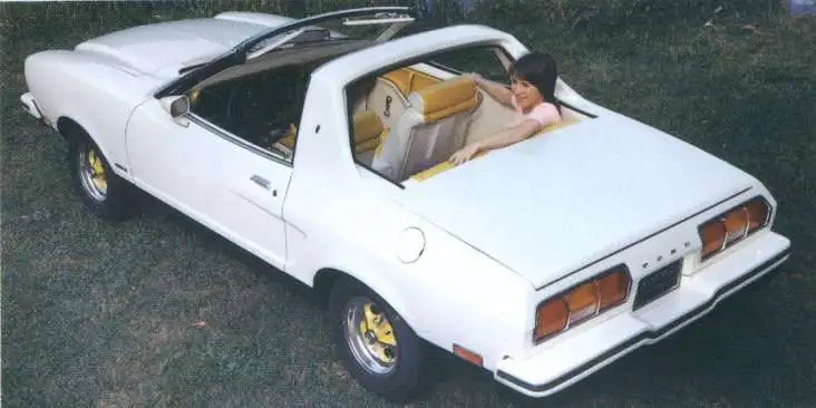

Why not do something like the mid 80's Corvette and have the roof cut to make a Targa top? I think that would look cool on a coupe
This is the Sportiva concept car...dating to 1974 or 1975. Looks to be a Targa top on a coupe body.
