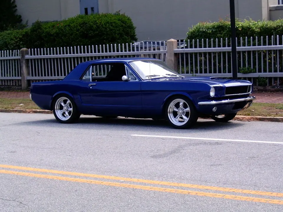

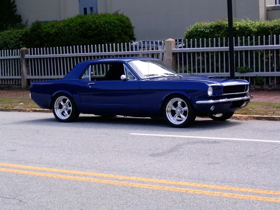

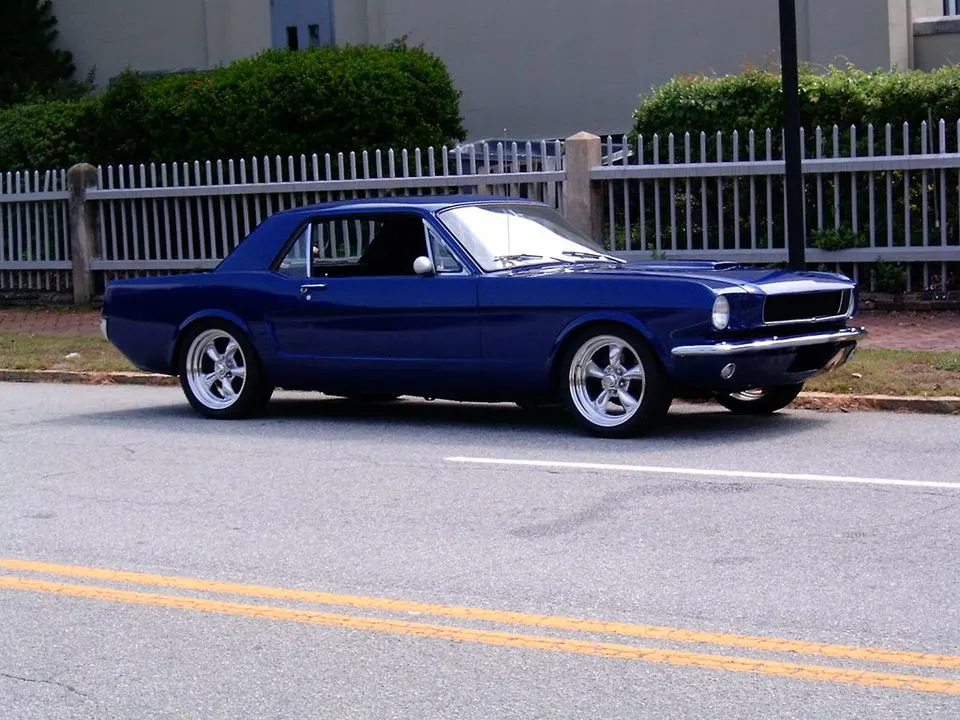

im not following what you are trying to say... did you sand the car with a lower grit than 2000 to begin with? what you may be seeing is sand scratches that the 2000 didnt take out (ive never used anything finer than 1500, followed by a wool pad, foam cutting pad, then foam polishing pad) what are you using to buff with? give me some specifics, and ill see if i can help...
a bit of my handiwork:D

That's pretty. If you'd like I'll drive the car out to you and let you finish it. :)
Any front pics ,I like the front panel . :nice:

the color is ford sonic blue... the light is playing off it a bit in this photo, it is an 04 mustang, and ranger color...it does look pretty awesome in real life, though...you can go to my photobucket gallery (chromedog65) there are more pics there, i think theres a frontal shot.
