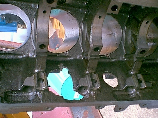

get forged rod. if your gonna compleately rebuild it, why take chance? it is cheaper to do it now, than later ya know. I rebuild my old MR2 befor, and just becouse it was with in spec, I reused rod, and replaced everything else. and look at the pic below to see what happened.
