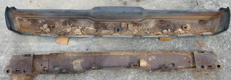

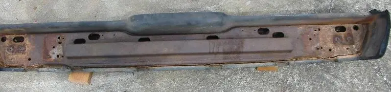

There are actually 2 steel support parts in both the front and rear MII bumpers...an "inner" part that is cast into the urethane skin, and an "outer" part that is bolted on.
Swapping a good outer is not a big deal. You just need the right size socket and a bunch of rust penetrant. If the inner is gone...I don't know what is keeping the urethane skin from acting like a wet noodle.
You may be looking at finding a new (used) rear bumper assembly...
Get some pictures of the inside of that bumper so we can see what's going on. Try to see the area where the urethane and metal are bonded together.
Assuming that you actually have a wooden 2x4 as a bumper support, if the "inner" is still good, you might actually be able to swap the wooden 2x4 for a length of steel or aluminum tube. Either would certainly have more structural strength!
I've attached 2 pics: one with the bumper removed showing the "outer" reinforcement, and the next with the "outer" reinforcement removed from the urethane skin and its "inner" reinforcement. The rust is mostly surface rust, and the junk is mud wasp nests! ;)

Great pics!
The bumper supports (shock absorbers) are factory. But that is definitely not a factory bumper reinforcement beam! :)
Its a nice job though. Looks like a solid piece. Maybe a little too solid...you might should dissassemble and drill it full of lightening holes. ;)
You can either get a used set of factory reinforcement beams, or you can look for a product that will "glue" your current reinforcement beam to the urethane skin. That's not as far fetched as it might sound...the original bumper skin had a thin metal panel "cast" into it. One possibility might be to take your current assembly apart, drill a bunch of holes in the reinforcement beam, and fill the backside of the skin with a urethane glue. Press the reinforcement beam into the glue and let it set.
In either case you will have to fill the bolt holes with urethane repair material...3M makes something just for this.
I'm really impressed with how good your custom reinforcement beam is...it would work well with a fiberglass bumper if you could work out a way to attach it without bolts...i.e. glue or fiberglass.
The pics I posted previously in this thread aren't very good, but you can get an idea of how a factory bumper goes together. In one pic the outer reinforcement has been removed, and you can see the "cast-in" inner plate under all of the broken dirt-dauber wasp nests
The outer reinforcement is a complex stamping with several plates welded on.
The inner reinforcement looks to be a flat plate with a slight curve and a couple of raised stands to bolt the outer to.
The reinforcements probably actually weigh about the same as the urethane skin. Its not nearly as heavy as I assumed before I removed it.
I'm going to carry the whole mess to the sand blaster soon and get them cleaned up for paint.
