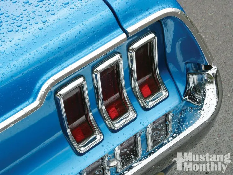

The molding was a semi-rare optional upgrade and you want to do away with it, and look like a low-option car? Paste some JB Weld on from the back and file it smooth.

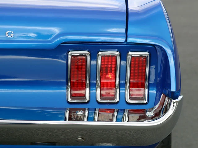

Well shiet, that's one fine looking molding free '68 you got there, LOL, that's proof it can look hella good, I was a bit worried about the flattened edge.
I am also going to loose the "M U S T A G" on the trunk lid, and all the horse emblems on the sides of the front fenders, if they don't know it's a Mustang they aint car people, so I don't care.

I agree with 2+2, I would not do away with that. It looks awesome! I always thought it could have been cool if 65-66 had something similar. The other pic looks nice asl well, but I don't think they look as good with all the emblems removed.
I think that stuff you got which is like JB Weld should do what you want.
I agree with 2+2, I would not do away with that. It looks awesome! I always thought it could have been cool if 65-66 had something similar. The other pic looks nice as well, but I don't think they look as good with all the emblems removed.
To each his own, my brotha, I on the other hand like a clean car, that means no unnecessary car jewelry. Do you know what it takes to keep a clean car, it is soooo difficult, you will have guys wanting to pin stripe it for you, or put flames on it, or paint a racing stripe, or put a vinyl top on it, install hood scoops, or hood pins, or chrome this, or chrome that. No Thank You!
