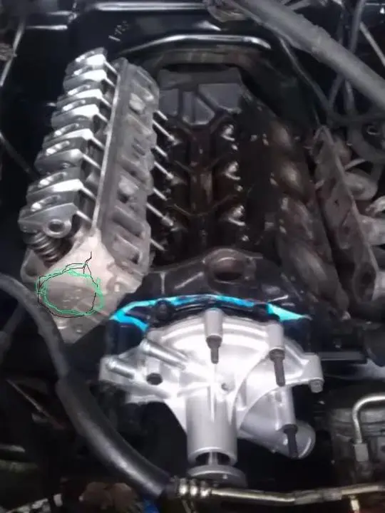

Should say SVO on both the front and back of the heads. This was the best picture I could find. I never did take any close up pics of these heads. I circled where it will say SVO. It does sound like they are GT40X heads though.

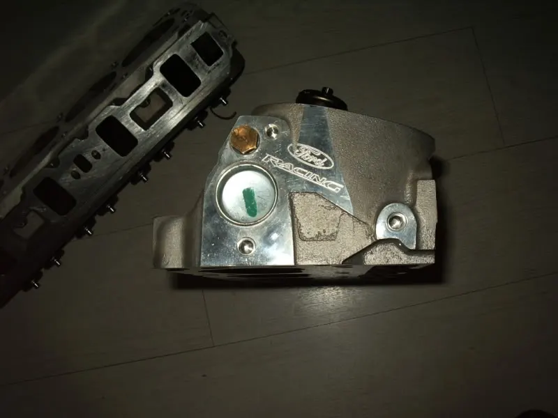

The newers GT40X have a "Ford Racing" logo stamped instead "SVO" ...

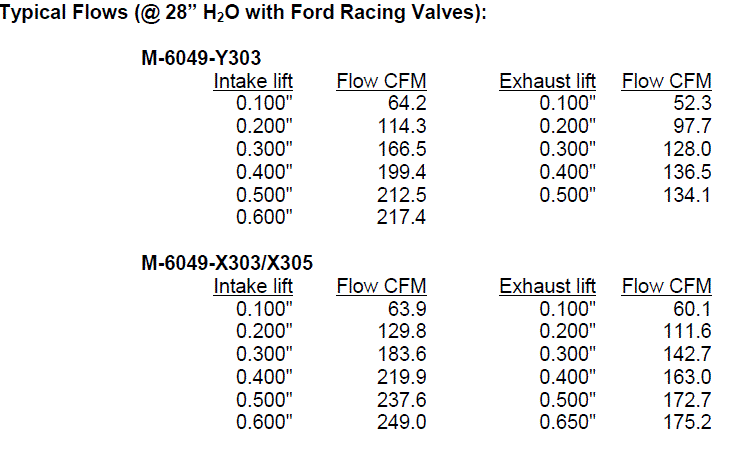

Yes , X-303 are 64cc chamber and X-305 are 58cc chamber . Both are pedestal mouting rockers and have 1.94" int./1.54" exh. valves . Here are Ford Racing flows numbers:

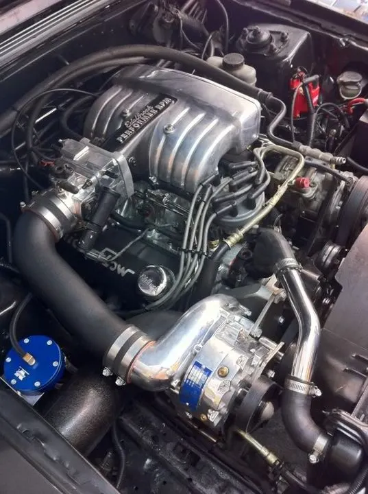

I bought my GT40X heads bare and upgraded the springs to Steeda Hi-Rev's and valves to Ferrea's. I should have had all the ports cleaned up. Lots of cast flash. When I upgraded to the 347 I went with AFR 185's so they were sold. They sat in Rogers (Green94 5.0) garage for like 7 years. They got dusted off a few months ago. They are now on his 1992 GT with Vortech V3i and my old Edelbrock RPM Polished Intake / 70MM throttle body. So 12 years later they are still going strong.
Here they are.
