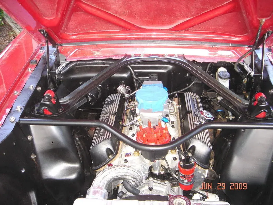

There are two water jacket ports on most intake manifolds. You can see both in this picture, there is one just to the left of the distributer and one just to the right (they are the brass plugs that you see just in front of the monty carlo bar). I use both, one for my temperature gauge and one for my EFI computer.
Also, if your stock gauge is not working, I would go ahead and order a new temperature sending unit. Make sure you get the correct unit for the gauge cluster you have.

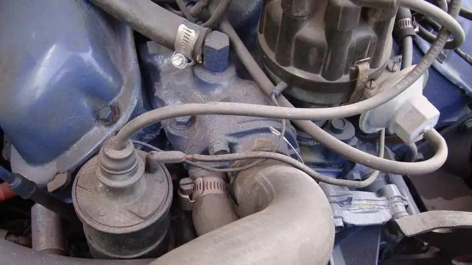

I dont but will this work?
Mustangs Unlimited - The Premier Source for Mustang, Shelby and Cougar Parts and Accessories
This is my thermostat housing
Okay, your picture reminds me that I used the water jacket port for my water temperature sender when I removed my heater hose. Sorry, I forgot about that.
The part you linked looks interesting. It will work once the thermostat is open, but until then you will not be receiving true engine temperature readings. I think it would be fine for a secondary sensor and/or to calibrate your existing gauge.
