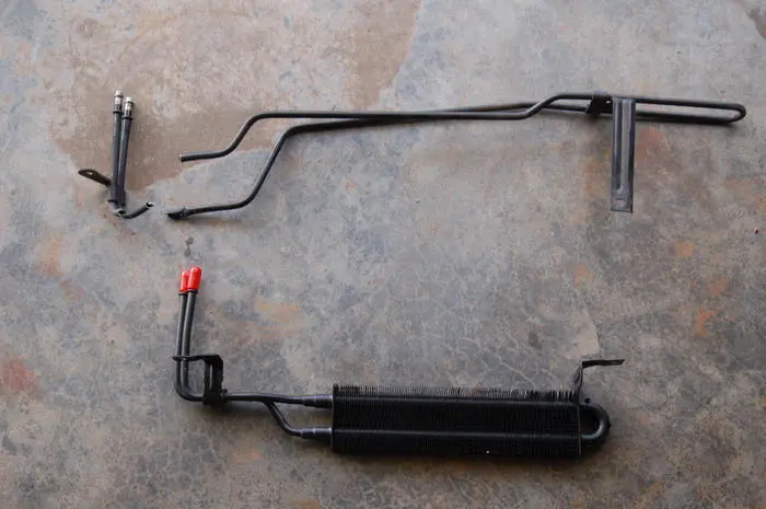

Once out, we can compare the two pieces:

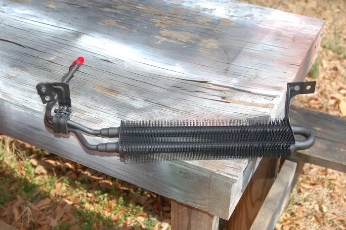

This is the modified unit, I had to basically move everything over 2.25" so it would clear the fans of the heat exchanger. You want to use the hole that the both the radiator support and heat exchanger support bolts too. This will be your reference starting point.

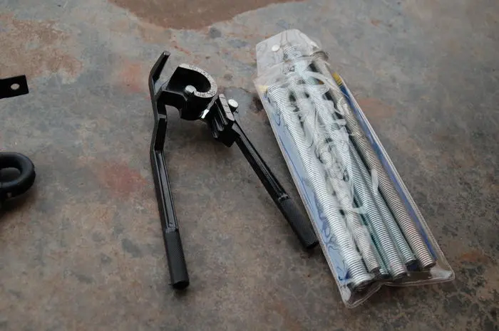

What I had to do was grind the ears off of the drivers side bracket so I could remove it, bend the tubing out straight, then rebend it closer towards the cooler unit to reinstall the bracket. Be VERY careful bending this tubing as it would be very easy to crimp and ruin the unit. I used two different types of benders, the spring type to straighten it, and the pliers type to rebend it. After you make the bends, test fit it to make sure it goes through the hole in the radiator support. Here are the two benders:
There is enough room in the other bracket near the end-loop to drill another hole. I also ground down the two end-pieces near the fins so I could get enough clearance to put it up into the car.

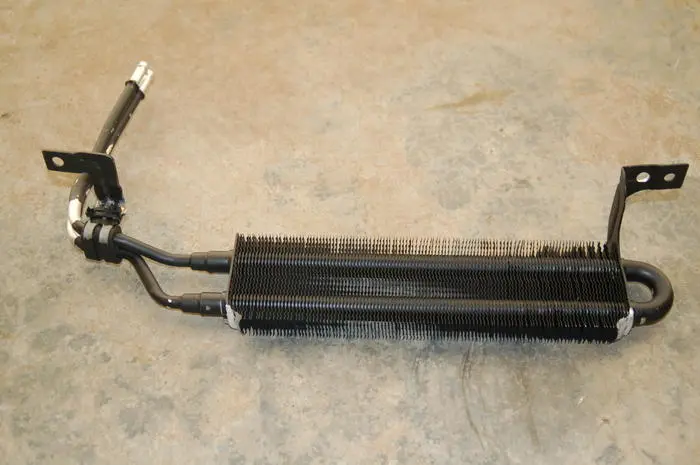

After that, I touched it up with some flat black paint:

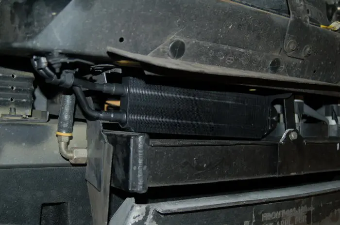

and installed it:

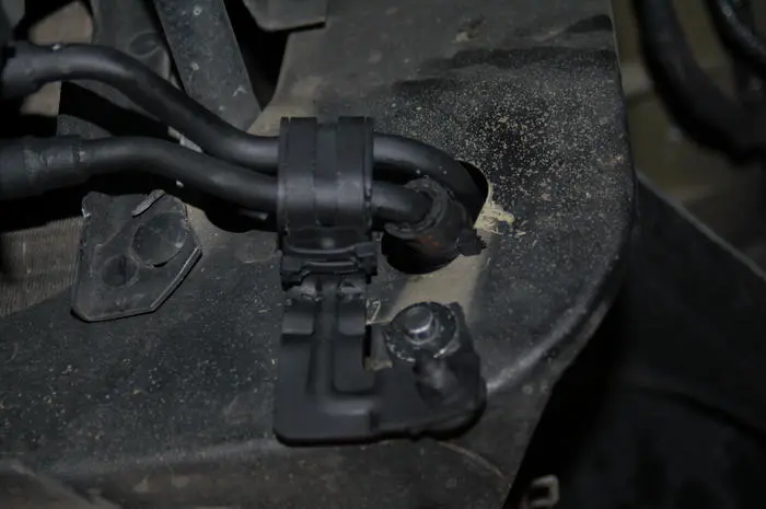

The hose was close in one area, so I covered it with some rubber tubing to protect it. You can also see where I made a drop bracket to fit the drivers side cooler bracket to the stock hole:

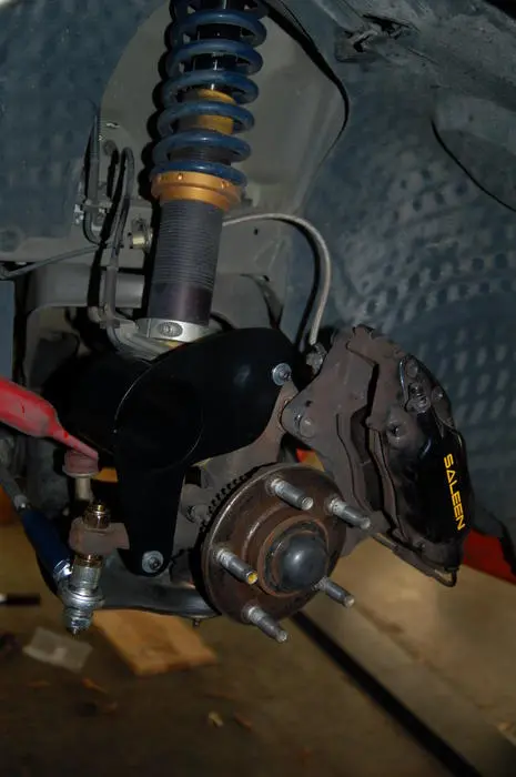

Finally, for fun, is a picture of the brake cooler brackets and tie-rod ends that I installed at the same time:
