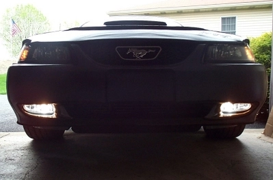

Mustangmike23, check out "my mods" page from the link below. I changed my fogs to the clear ones, and I have a short write-up on the experience.
