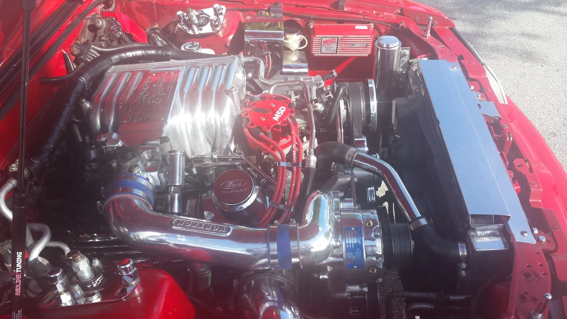

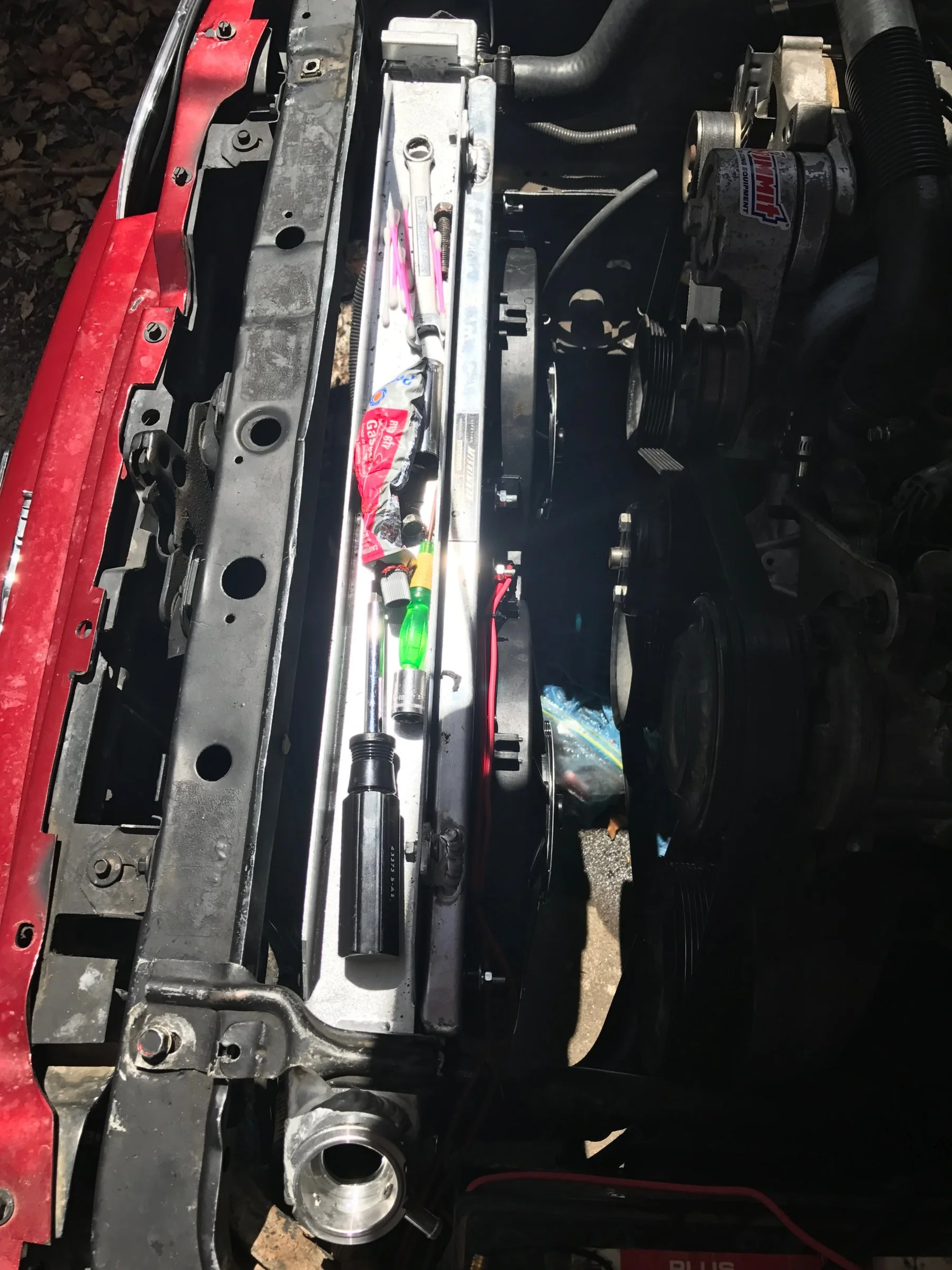

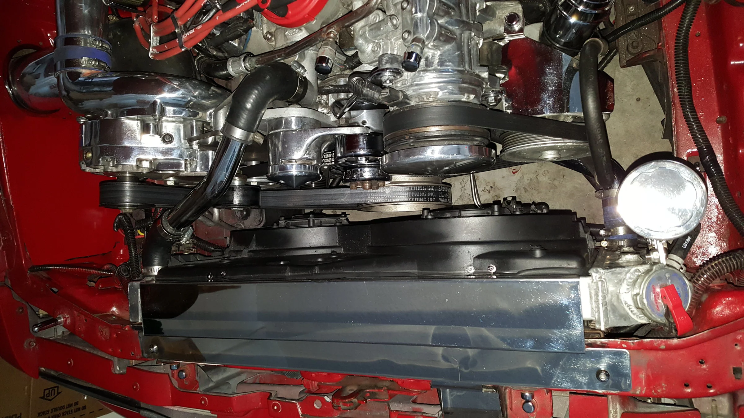

post pics of your setup.. most people fabricate up bracketry from from Home Depot. I had some flat brackets welded to the radiator tank. You can also use the eixisting holes for the trans cooler in a radiator with trans cooler fittings, if you have a manual transmission or run an external trans cooler,. Not the best pictures but you get the idea
