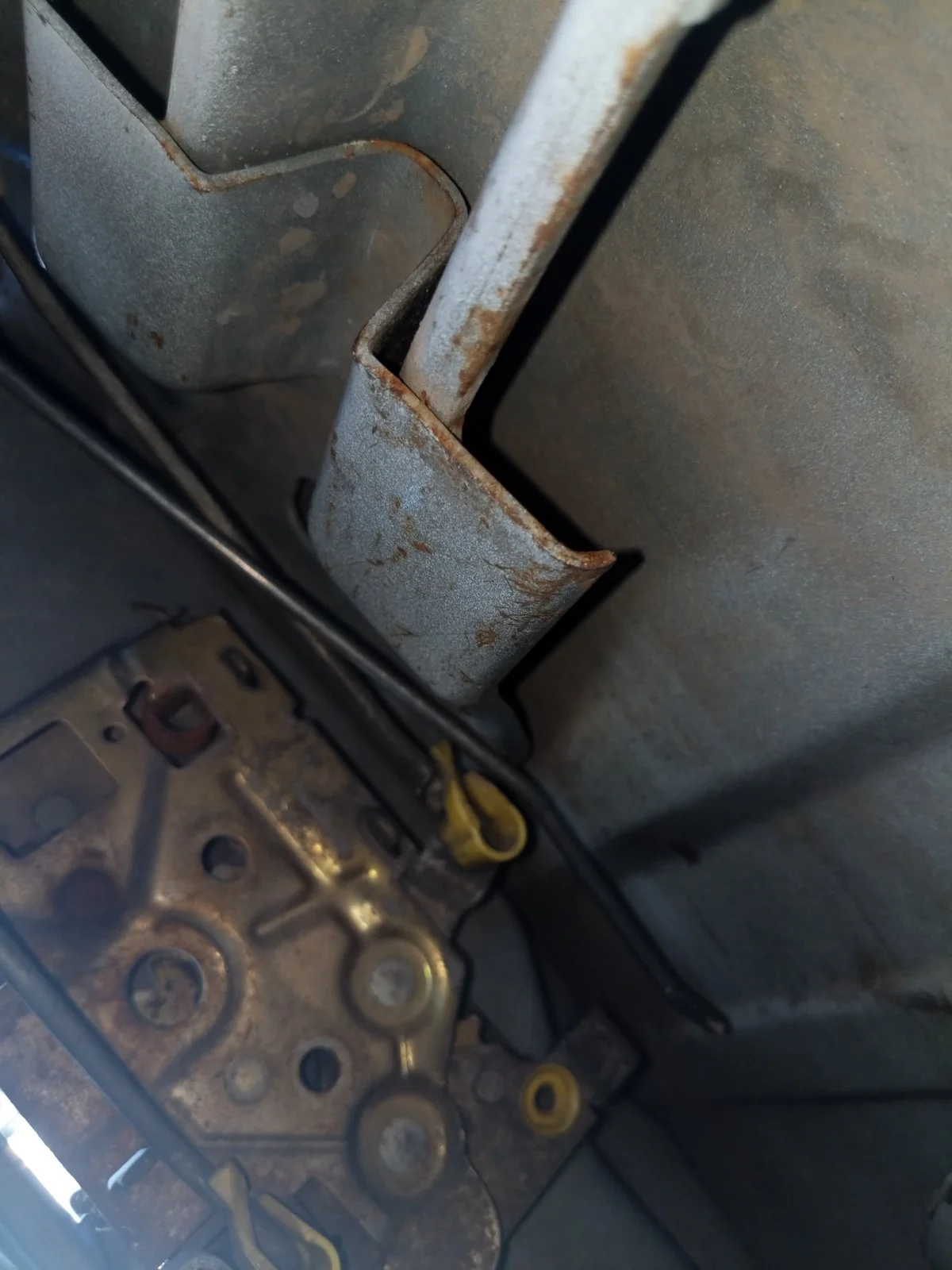

Does anyone have any helpful hints on how to install new lock cylinders on a 91 GT? I have them in place but can't really tell the best way to attach the bar that runs from the cylinder to the assembly for the remainder of the lock assembly.

Your pic answers your question. put the dangling rod end into the only empty hole that is open. ( hint.....its yellow)
You have to thread the " s" shaped rod end through the hole first, then snap it into the yellow lock grommet on the lock arm.
