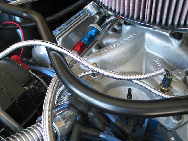

That is a good and creative idea, but I've used both of the intake fittings already, one for the temperature sender and the other for my thermostatic switch. Here's a snapshot where you can see how cluttered it is getting, I'd like to keep it as clean as possible.

Can you see the switch I have in my manifold (the brass colored one on the right)? That is an off-the-shelf part for a 1990 Taurus, it is simply an on/off switch that is activated at 180 degrees. I thought long and hard about using it for my water pump but left it for just the fan instead since I was fearful of creating steam pockets in the water jacket.
