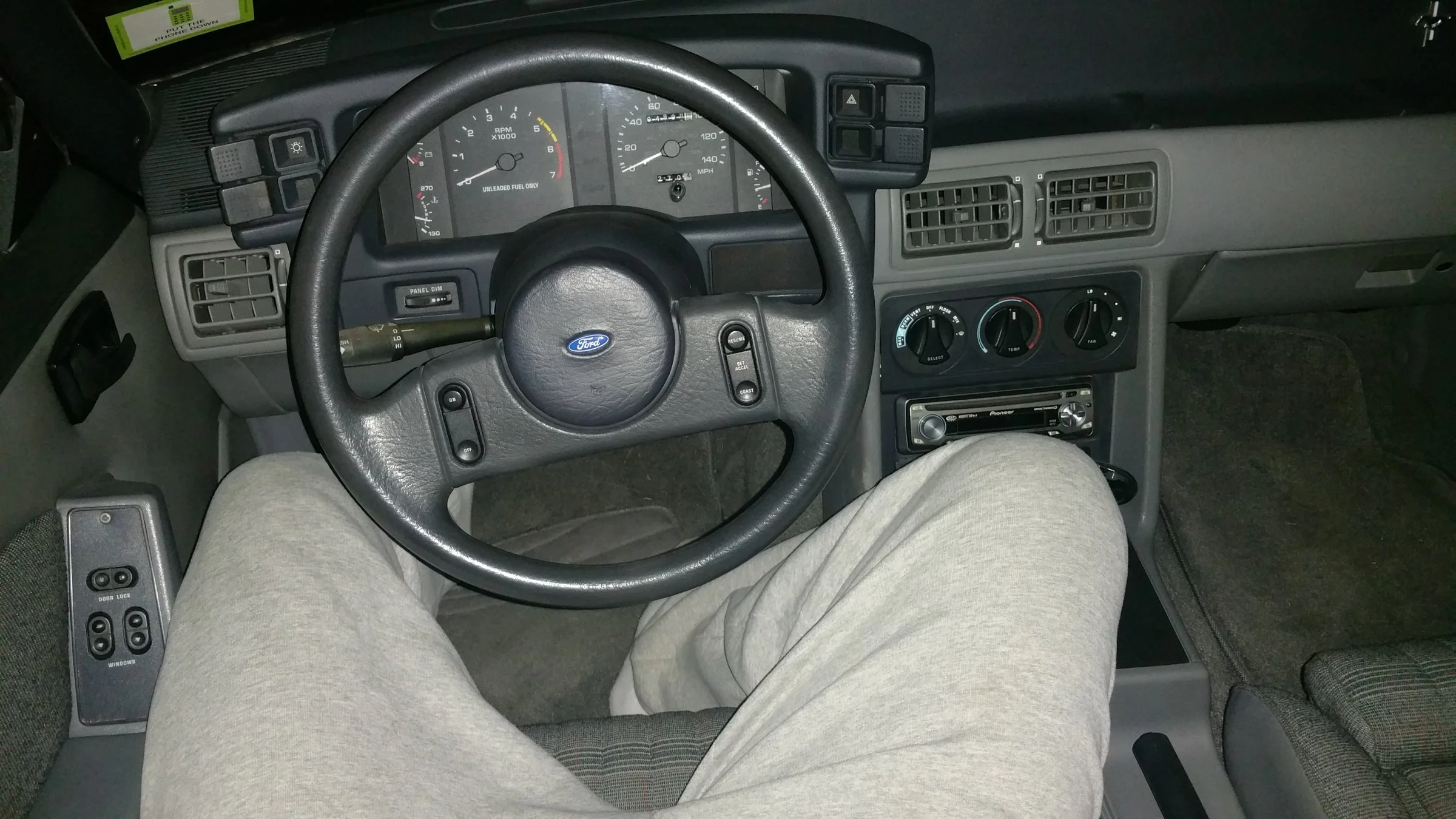

Interesting. I'm wondering if my stang has 60,000 or 160,000 miles. My pedals show no wear. Just some normal stains from dirty shoes.
The stock torque boxes look great and it still had the stock 2.73 gears along with the aod, so the engine hardly ever saw rpms higher than 2000. This car confuses me. There are signs of high mileage and signs of low mileage. When I took off the valve-covers, there was a lot of hard dried oil glaze (dark brown grime) covering the underside of the valvecovers and inside the oil breather/filler neck and a little grime on the valvesprings. No sludge or carbon though. The inside of the throttlebody and intake manifold was soaked in oil also, due to a clogged PCV filter. The driver side seat also had a busted bolt which caused the seat to lean back all the way down to the back seat. Odometer shows 60,422 miles now, so I put 422 miles in it since I bought it back in july of 2015. lol

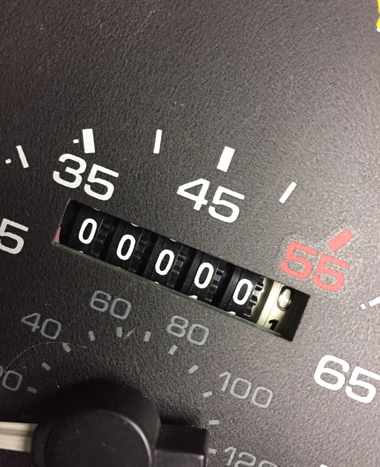

My 90 has 55k on it and the records support it. Also, the numbers won't line up perfectly on one that's rolled over although that can be fudged. Problem with mine was the PO had some Jiffy Lube style place do his oil changes so when I did the first one as soon as I got it I drained 8 quarts out. Good thing I pulled the front plug first or my garage floor would have suffered greatly.
I'd love to know why the red "55" looks like a sticker. I've wondered this all the way back to when my Dad picked up his new 87 GT. Some sort of govt regulation that it needed to be red?? Hmmmm....

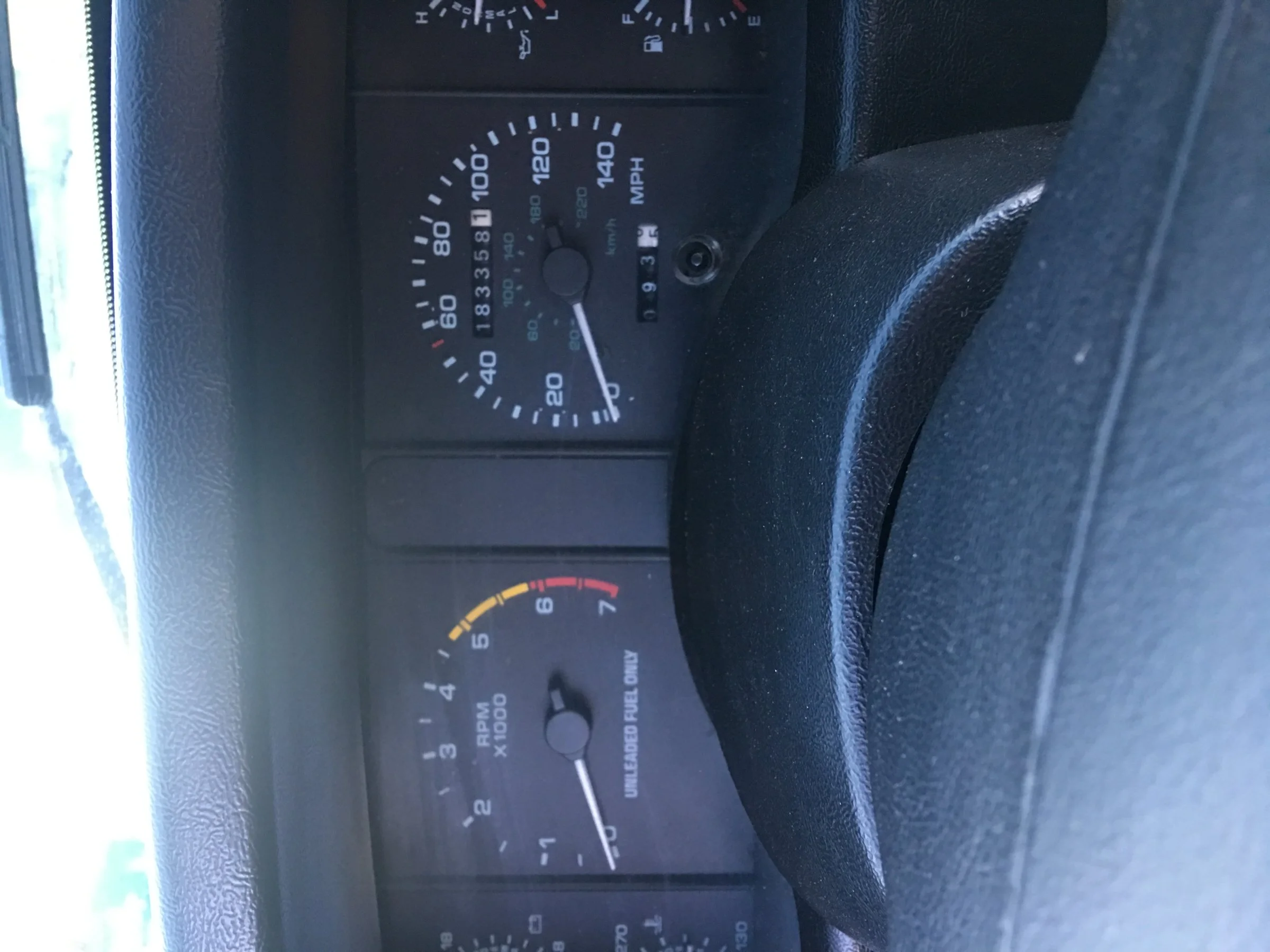

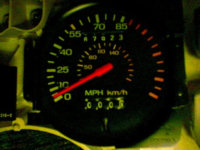

National speed limit was 55MPH up until 1995 or so. A law written in 1980 dictated that the number "55" be emphasized somehow, and the max speed a speedo could show was 85MPH. That'w why the SVO got speedometers that go to 140 but only numbered to 85MPH.
The law on 85MPH speedos was actually repealed sometime in the 80's. The Mustang finally went 140MPH in mid 1989, but kept the red line at 55MPH up until 1995 when the national speed limit law was repealed. It was finally removed in the 1996 cluster.

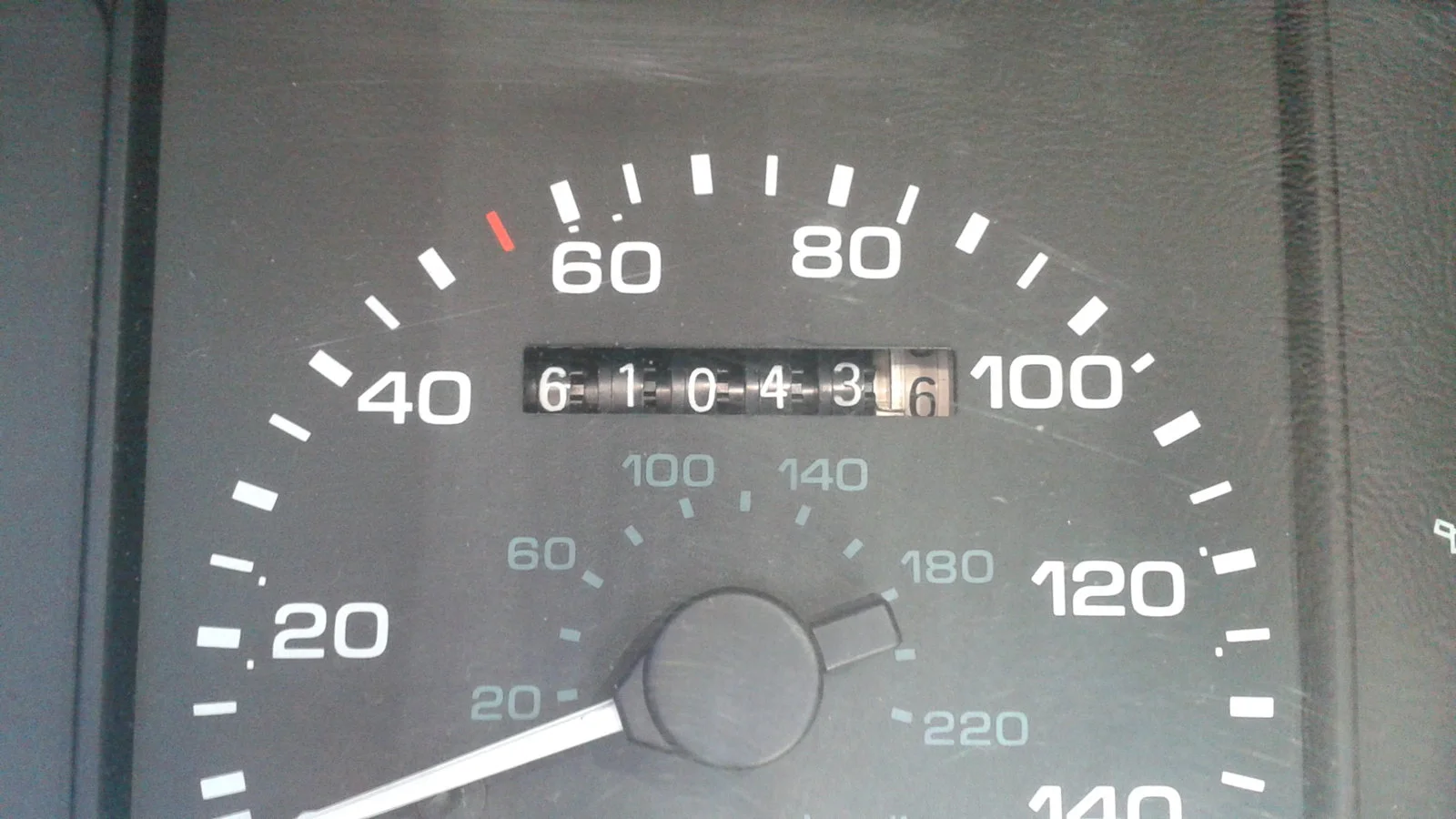

usually when they roll over, that first digit is a little offset. That one looks straight. Could be 60k.
Have you done any carfax reports to see if anything was reported between 60-160k miles? Usually any registration or inspection generates a record
