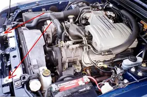

Well, you have to take the lights out if you want to remove the bumper cover only and not drill out rivets. There's bolts that hold it on each side to the fenders and a few in the engine bay that screw it to the front. A few of the bolts you can get to from the engine bay and a few that I've found easier to remove from underneath.
These are the 2 in the engine bay
