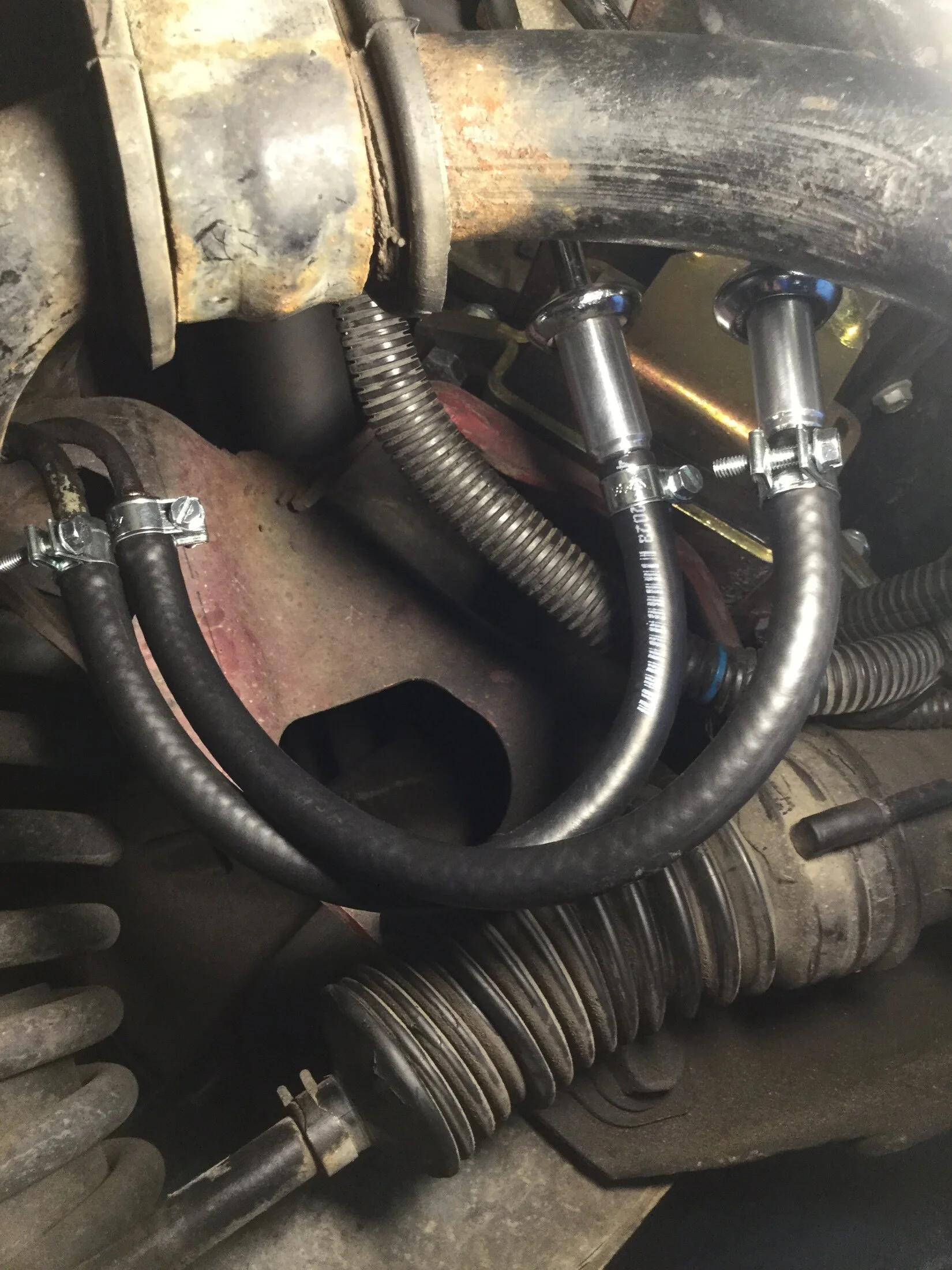

Finally got the fuel lines installed. Thanks for all the help from everyone on here!
Hers's some tips from the mistakes I made that I'm going to pass along so no one has to go through what I did! I wasted 3 cut to size lengths of hose. Good thing they give you a generous amount of hose.
1- When you cut your lines to length, Attach two hose clamps in the middle of each hose facing in the direction that you want them. That way you won't put the hose on the barbed fitting and then realize you forget the clamp. That hose isn't coming off unless you slice it with a utility knife. If you do have to cut it off, make sure you don't cut into the steering rack boot like I almost did!
2-Do the lines going back to the gas tank first. They are the hardest to get on. I lubed the hard barbed lines with Lucas Oils Fuel Treatment. Take the cap of a water bottle, pour some of the fuel treatment in, then use a couple swabs together to lube one fitting at a time.
3- Wash your hands if you get any grease or oil on them. You won't have a good grip to push the line on.
4- Have 1 swab ready sitting in the fuel treatment. It's for lubing the inside of the hose after you heat it.
5-Then you have to heat the end of the line with a blow dryer. It takes about 5 minutes to get them hot to the touch. I wouldn't use a heat gun. There's a
chance they could melt.
I couldn't get the hoses all the way seated without heating them. I had to cut them off a couple times when I was just using the lube.
6- When hose is hot enough, quickly put the fuel treatment in the hole of the hose and coat the inside.
7- Get under your car as fast as possible without knocking yourself out and push the hose on firmly. It should slide all the way on.
8- Slide the clamp up and tighten it up.
9- Repeat the steps for the other one next to it.
10- The connections from the fuel rails go on easier. They didn't require heating. I just lubed the barbed fittings one at a time. And lubed the inside of the hose. They slid a lot easier than the ones going back to the gas tank.
11- Don't forget the fuel safety clips. Mine aren't on in the pic for a better view.
I hope this helps anyone doing this Fuel Hose Kit. I chose the Lucas Oil Fuel treatment for lube because it's made for the entire fuel system. No contamination.
I recommend lubing one barbed fitting at a time. That's so when the lines are so close, like the ones going to the gas tank, it doesn't get on your hands and the outside of the line that you are pushing on. Also, put the clamps smooth side back to back to prevent damage to the hose.
