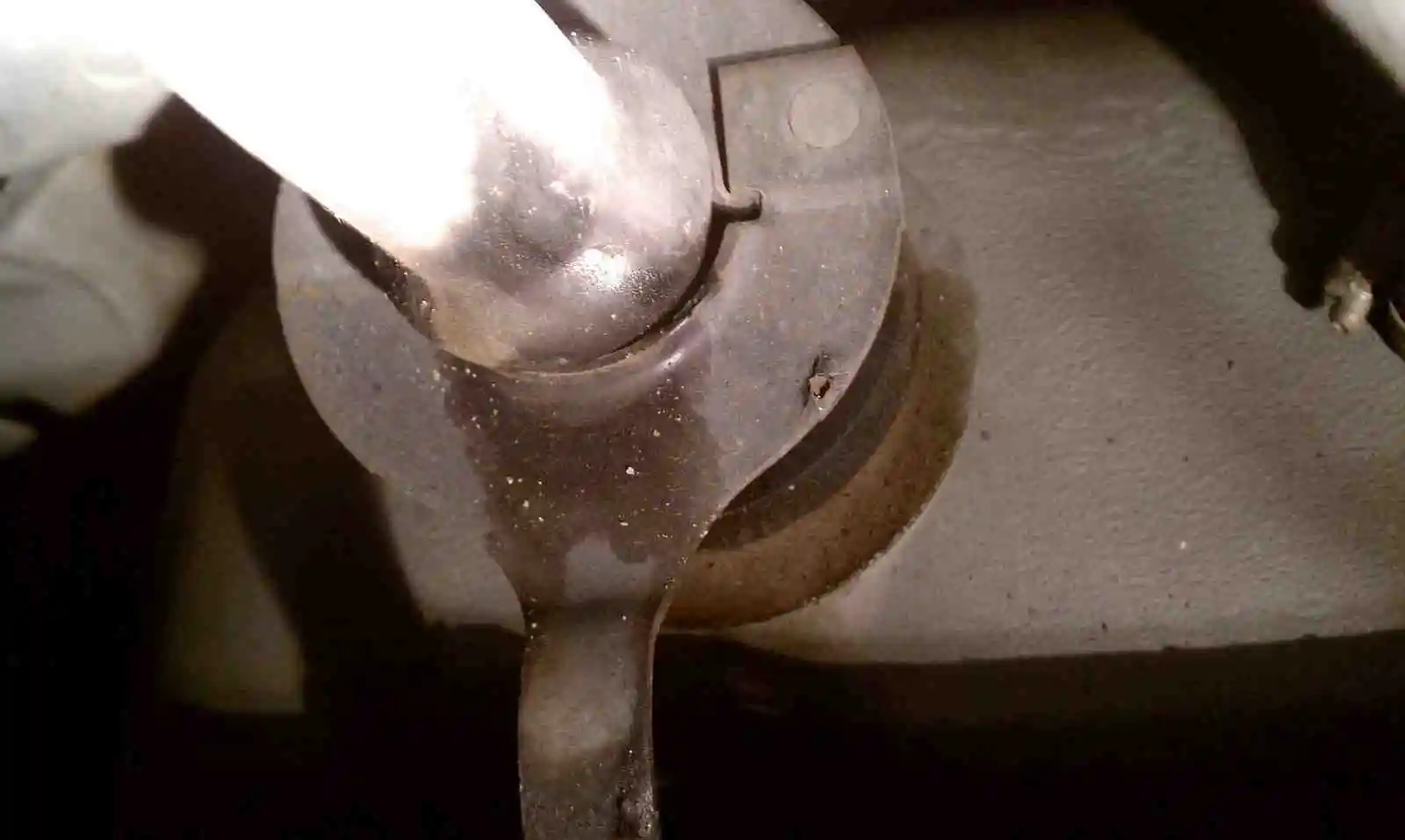

How important is the collar on the filler neck that's down by the rubber donut at the tank (step one in the first post, pic below)?
I installed a new tank and it doesn't have a hole to secure this collar. I could drill one in the lip but it is very close to the pinch weld seam.
