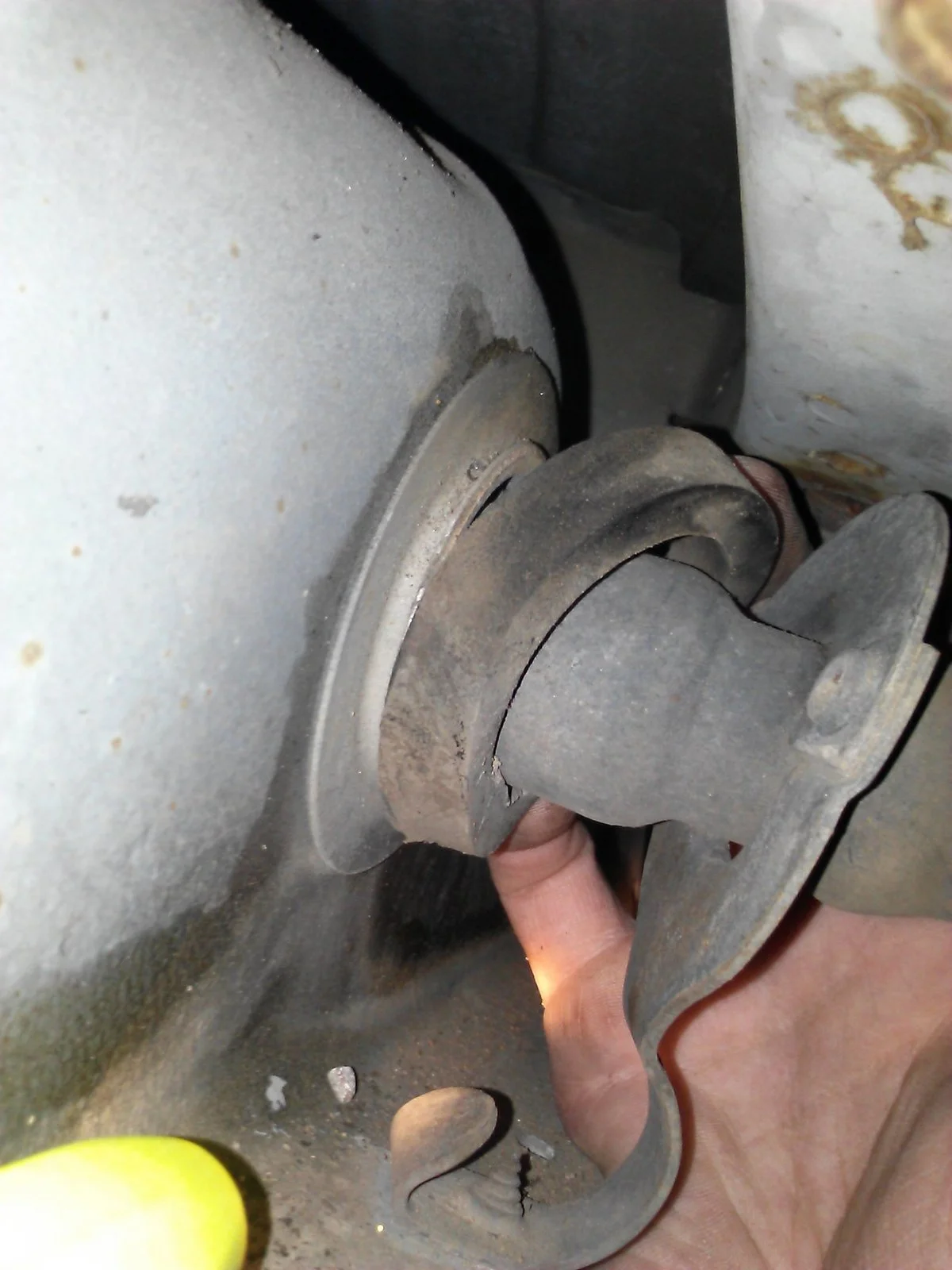

Sorry for reopening an old post. The wife's 2001 coupe has the same issue as the OP, real strong fuel smell. Driving home last night had someone pull up yelling about there is fuel coming out from under the bumper. Car has popped two codes PO455 & PO457, I replaced the gas cap and no change. Looked under car tonight to see the gasket as seen in the image. Turned the car on to see any leaking and the only leaking was directly out of the exhaust....not on top, inside the pipe? I'm going to replace the fuel filler tube gasket on tuesday when it comes in but if there is indeed fuel coming out of exhaust this concerns me. Anyone have any thought on this? Thanks in advance.
I figured it's a fire hazard, but I'm not convinced that it's fuel. If it was an injector issue the car would be running like :poo: and it runs fine just has the gas smell. I'm assuming the gasket in my pic shouldn't be flopping about on one side and that half of it is likely broke off inside the tank?
Im not sure if it is or isnt a this point. Fix the grommet first and go from there. If gas is spilling out of the exhaust you would notice it in your wallet as well. Everywhere you go you would be losing fuel. The gas smell is probably the gas smell coming from the tank. Definately was the case with mine. And yes if the halves have seperated which it may not have yet then the other half is in the gas tank. Your gonna have to fish for it. Not hard to do tho. Hope the grommet solves the problem.
