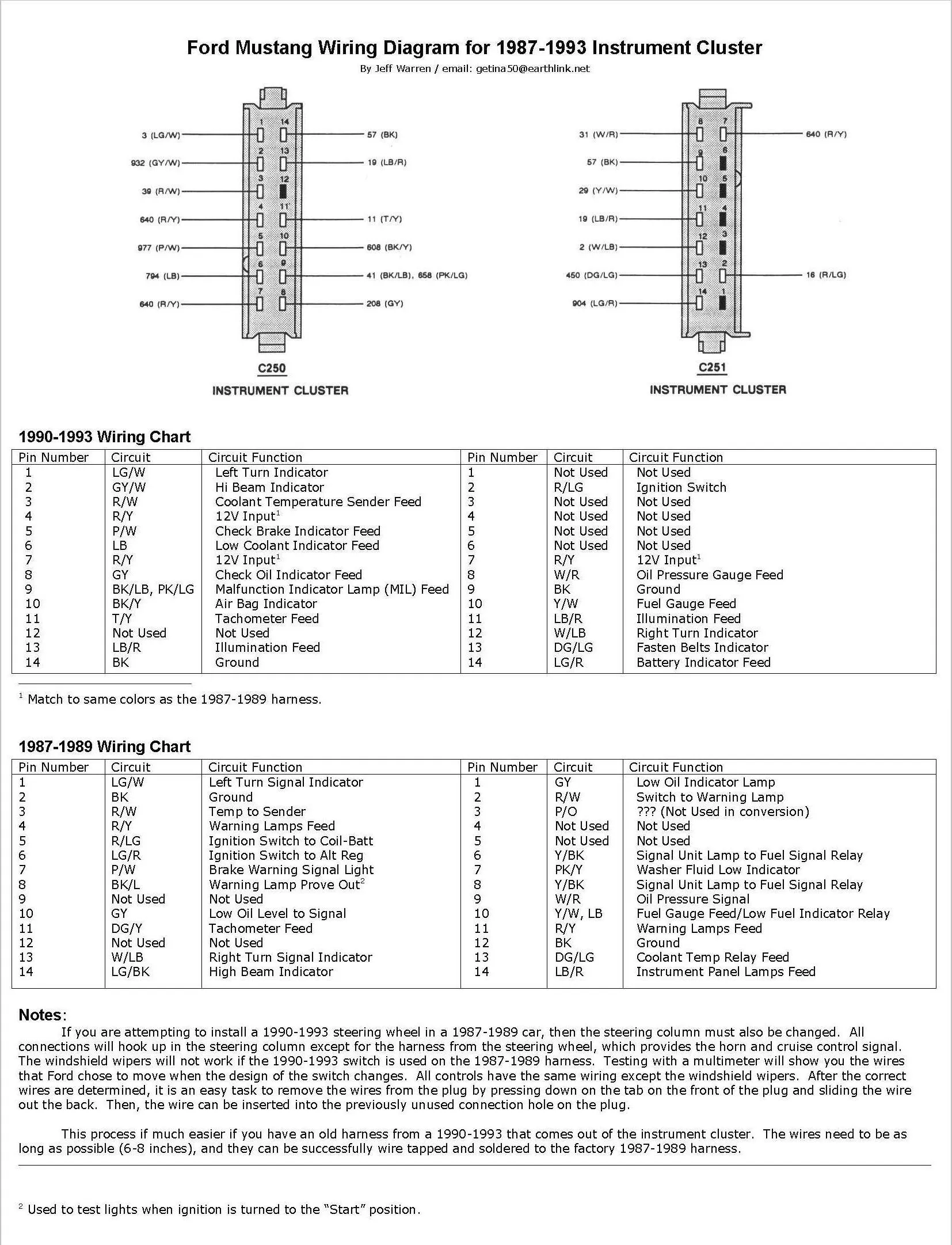

B Bite_ME New Member Apr 22, 2008 29 0 0 Jul 18, 2009 #1 Jul 18, 2009 #1 I have a 87 and just brought a speedo from a 90, does anyone have a wiring diagram to repin the connectors ?

jrichker StangNet's favorite TOOL In Remembrance. Thank you for your contributions Mar 10, 2000 27,512 2,811 234 Dublin GA Jul 18, 2009 #3 Jul 18, 2009 #3 See http://www.stangnet.com/tech/cluster87-93.pdf for information on the wiring differences, The clusters are interchangeable, but you have to do some trimming & move some wires.
