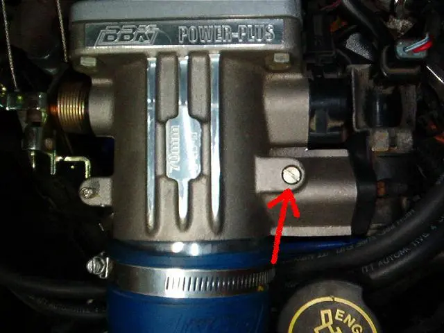

mustard New Member Aug 30, 2004 4 0 0 Sep 12, 2004 #1 Sep 12, 2004 #1 does anyone know how to set up BBk throttle body/idle? I have a 95 mustang 5.0 L with a 70mm BBK throttle body. Does anyone know how to set this up? Attachments throttle_body.webp 26.6 KB · Views: 254

BlackVert 15 Year Member Oct 3, 2003 5,589 9 98 Bethesda, MD Oct 2, 2004 #3 Oct 2, 2004 #3 i just got one too (used) ... i haven't compared it to my stock one, but isn't it pretty much of a straight swap out?
BlueOvalStangGT Active Member Oct 27, 2003 2,849 0 46 Tampa Florida....USF!!! Oct 3, 2004 #4 Oct 3, 2004 #4 I installed a PP 70 mm tb on my car not to long ago. Straight out swap but I did have to drill the holes out cause of crappy fitment. The TPS is not adjustable on our cars so dont bother with it. Plug and play
urban96 bubb rubb says:"woo woooooo" Founding Member Sep 24, 2002 3,464 1 69 Syracuse, NY Oct 3, 2004 #5 Oct 3, 2004 #5 yea pretty direct swap, i also found that the little screw in the photo should be either all the way down or backed out only about one turn
