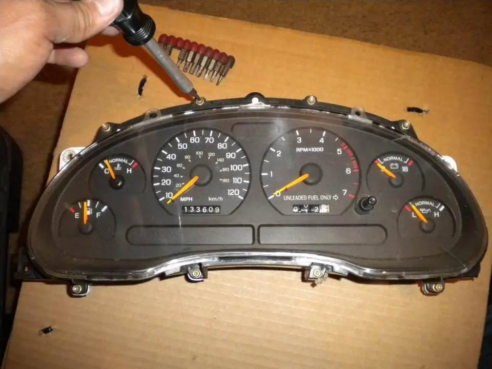

here's how to swap the odometer.
i'm using a 96 V6 cluster for illustration purposes only.
use same procedure on the 94-95 GT/Cobra cluster.
-Tools Needed-
1-T15 torx bit/driver
1-1/4 drive ratchet
1-3/16,1/4 drive socket
1-small flat head screwdriver

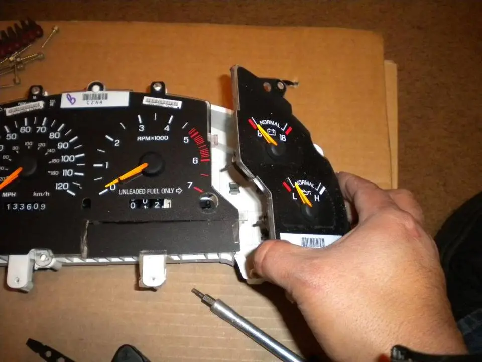

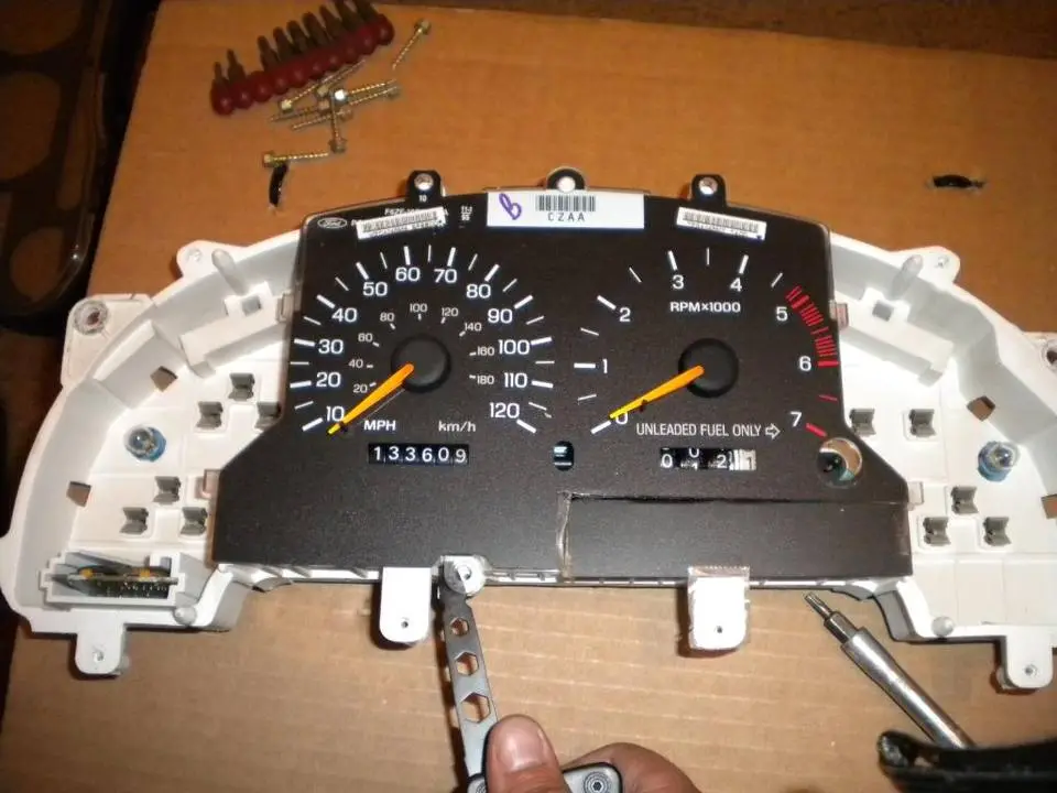

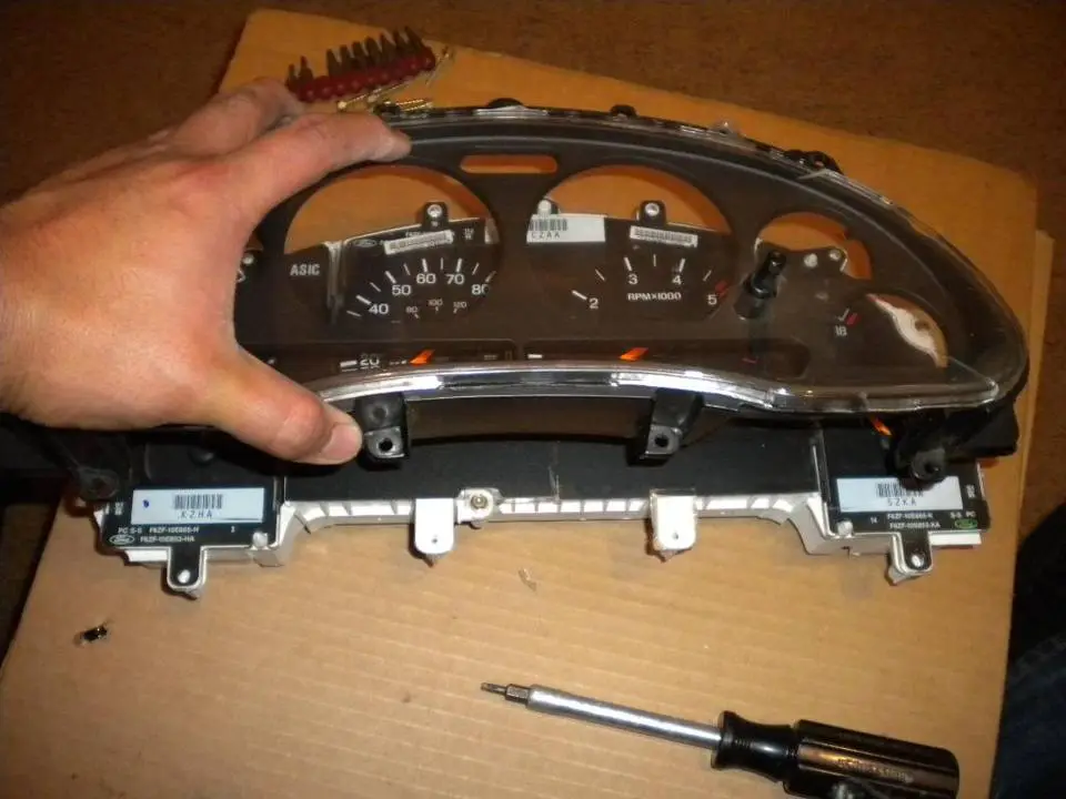

on front,remove 8 T15 screws around the lens.
lift lens straight up and set aside

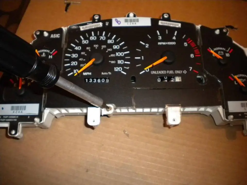

remove 1 T15 screw.

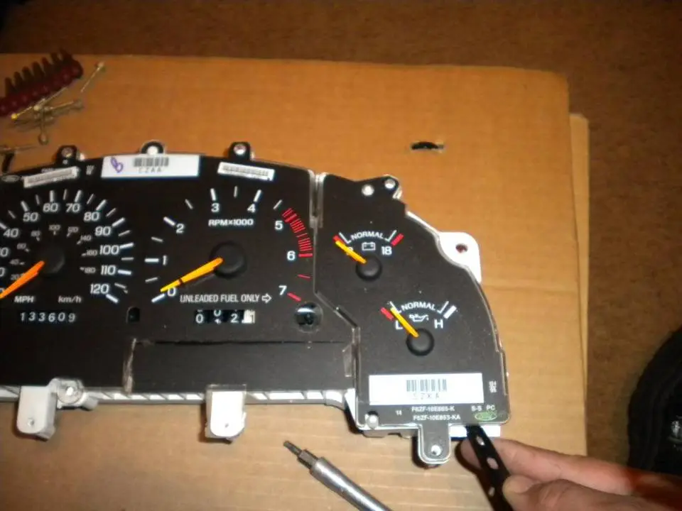

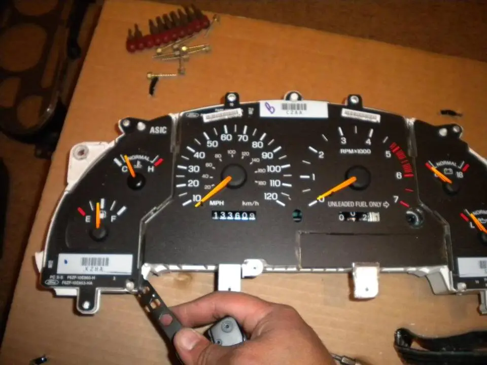

pry up coolant/fuel unit.
lift straight up and set aside.
same for volt/oil unit

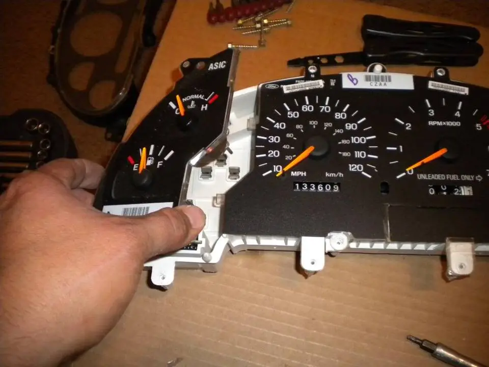

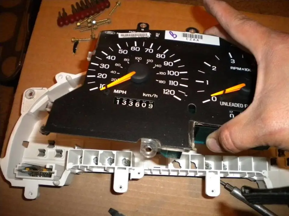

pry up speedo/rpm unit
lift straight up.

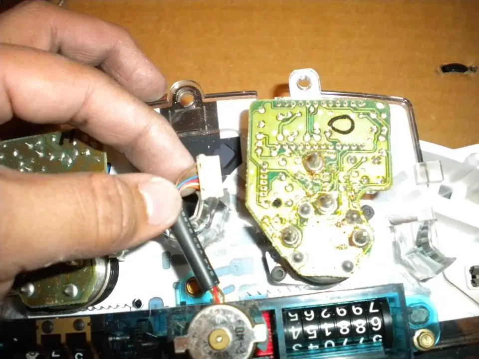

flip over and rest on housing.
**make sure its not on the needles**

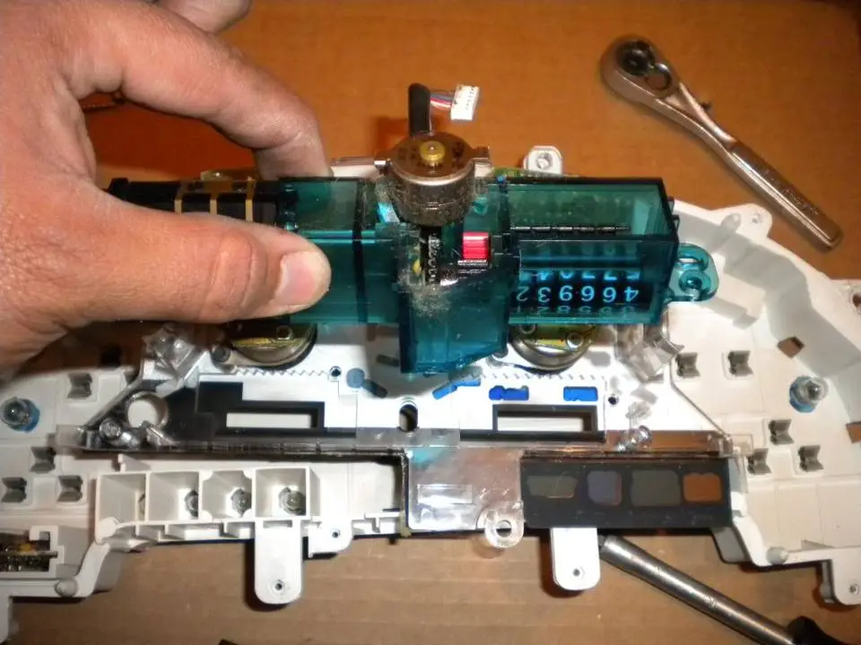

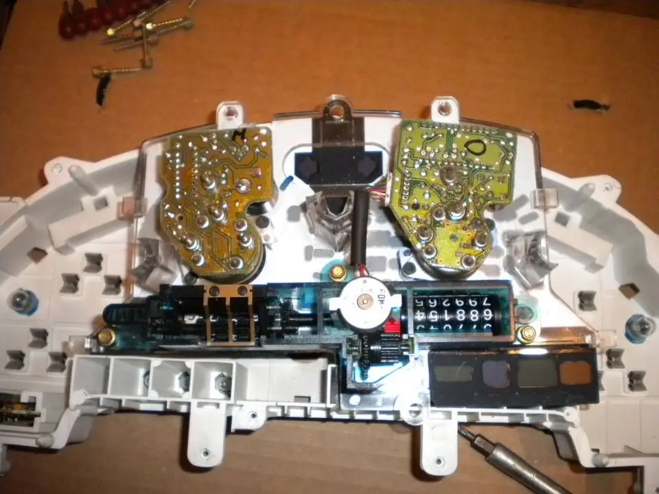

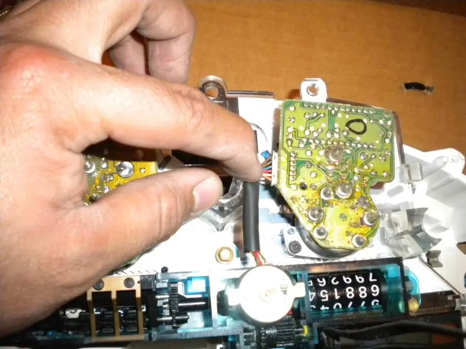

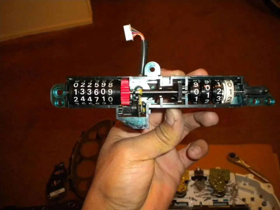

disconnect odometer motor harness.

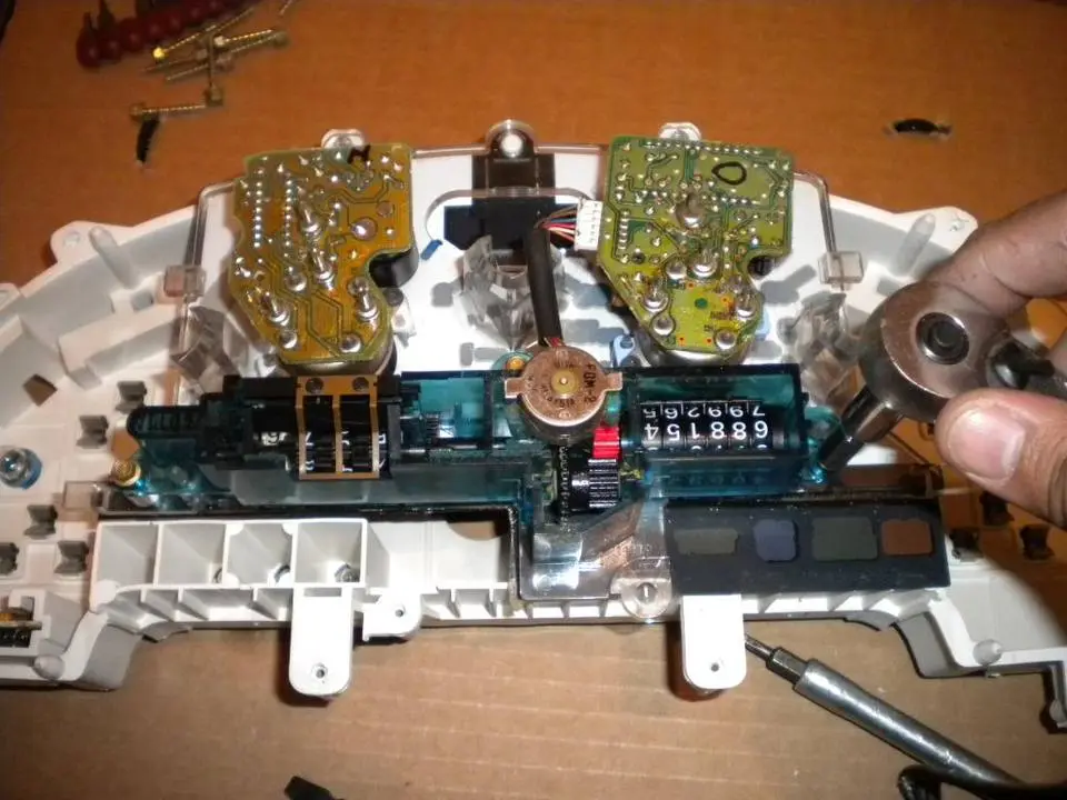

remove 3 3/16 screws attaching odometer unit to gauge.
lift straight up.
install is reverse of removal.
