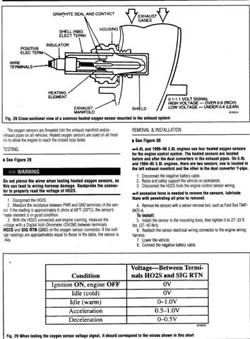

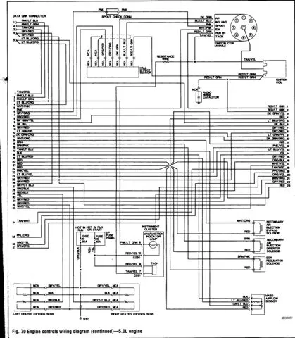

heres a wire schematic of the oxygen sensors and instructions on how to test....hope these pictures work you might have to print to enlarge...but as said above with the mileage they should be replaced....

If something is up with both O2's and they are acting equally, I would look at wiring or other issues first (the chances of them both taking an equal-sized dump is not likely).
BUT, since they are original, they could probably stand to be renewed. I just said what I did above in case new O2's doesnt make a magical difference.
Were I doing the exhaust work and had orig 100K lambdas, I would swap them if funds allowed (mine are a real pain to access with the aftermarket exhaust).
Good luck.
