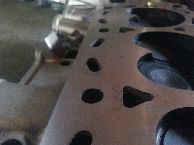

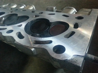

9 98Mustang2017 Active Member May 3, 2017 162 16 38 ct Jul 18, 2017 #1 Jul 18, 2017 #1 Paid $190 to get 2 cylinder heads worked on and i believe they barely did anything to it. Thanks for checking it out:

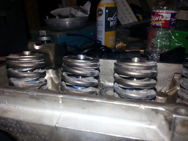

9 98Mustang2017 Active Member May 3, 2017 162 16 38 ct Jul 18, 2017 #2 Jul 18, 2017 #2 Also they have these things that appear to be inner springs. Like dual valve springs but i can compress them too easily with a flathead screwdriver. Takes about 3pounds of force to move the inner . Did not have these before.
9 98Mustang2017 Active Member May 3, 2017 162 16 38 ct Jul 18, 2017 #3 Jul 18, 2017 #3 Pic 1 of unsurfaced gasket Picture 2:
robertsa Well-Known Member Apr 22, 2017 159 44 58 San Antonio Jul 18, 2017 #4 Jul 18, 2017 #4 I think it's your floor that's not level. It rocked one direction until you moved it closer to the camera, then it rocked the other. Use a straight edge across the head. Reactions: 98Mustang2017, Neuron and RaggedGT
