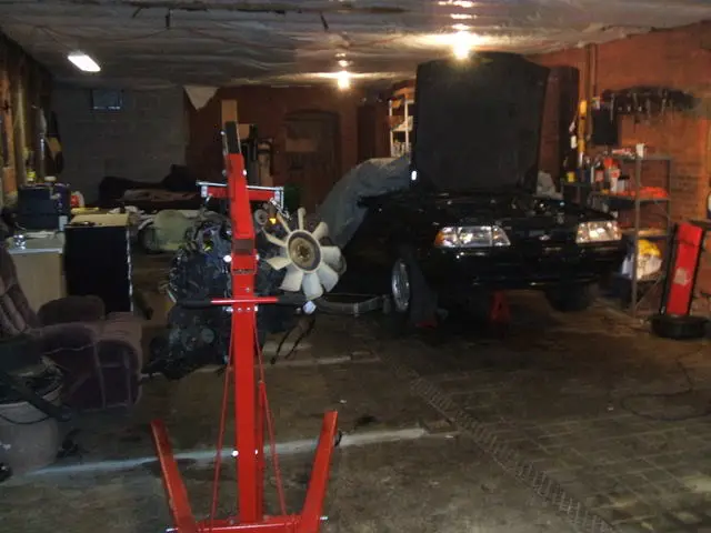

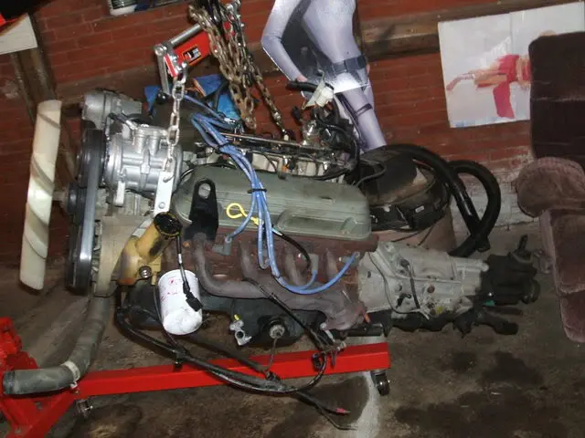

you did a lot of crap u didnt need to do. all you had to do was undo the driveline, wiring harnesses and motor mount bolts. mch easier this way. here is a pic from right after i pulled my engine when it was 100 percent stock. i even left the radiator fan on
Ha well it was my first time. I just wanted it out so i took it all apart!:D I think i'm going to install it all together. Thanks for the photos man!
