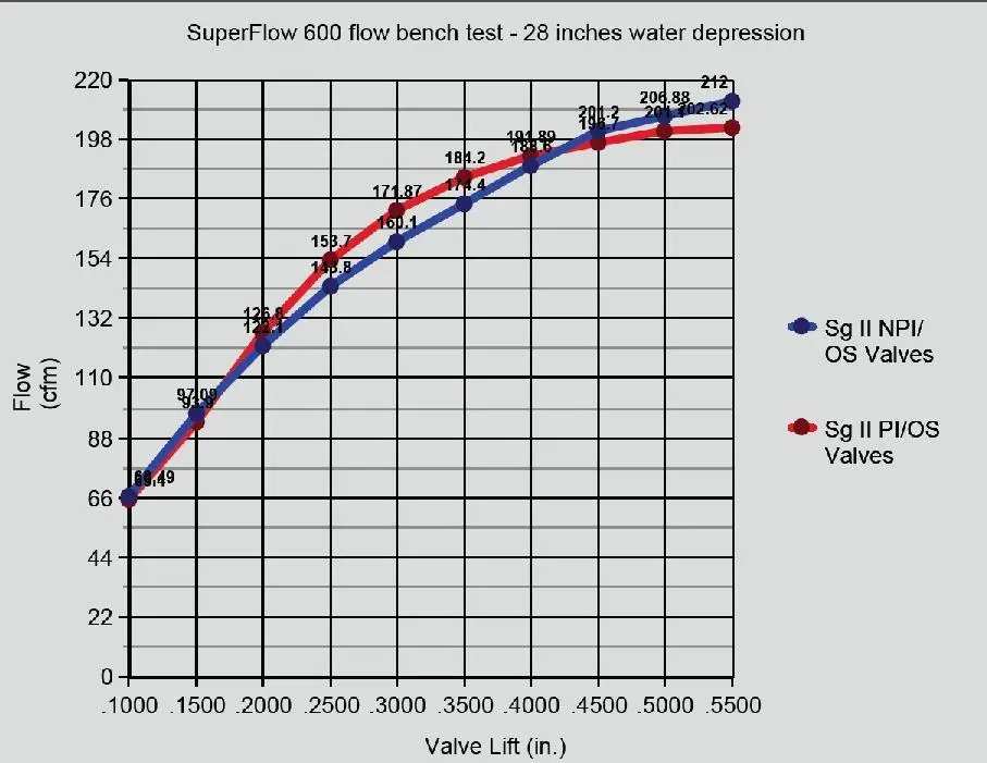

ok so i read .50 instead of .05 - calm down. I've seen previously posted numbers:
Lift in Inches – Non-PI (’96-‘98) – PI (’99-’04)
.100 – 061 – 060
.150 – 089 - 086
.200 – 112 - 116
.250 – 131 - 141
.300 – 146 - 160
.350 – 160 - 169
.400 – 173 - 176
.450 – 185 - 182
.500 – 188 - 185
.550 – 193 - 186
And talking personally with the guy who ports mustangs heads at Total Performance where he tested to two on a flow bench, and the guy who bought the ported NPI heads after having a pair of ported PI heads for 2 years that they (according to his dyno results) flow better primarily up top. HENCE either this is true or porting NPI heads isn't uniform across the board - so don't go around saying people are incorrect when you have the narrow perspective of one instance.

Good info to know. Does he have any flow charts?
Like this:
http://www.mediafire.com/?nk0zk4lgl3x
And i do recognize every porter is different and instrumentation used to test flow changes, just think it'd be a good idea for a tech thread.
Looks like in this case the NPI head has a small advantage early in the lift cycle as well
